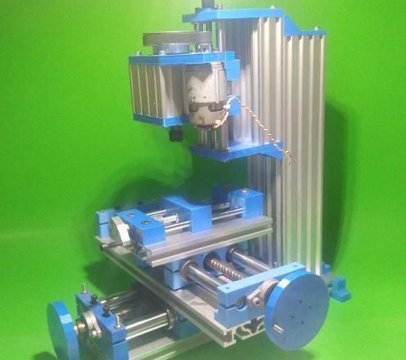

Step 1: DIY Mini Vise Clamp
1 20120 aluminum extrusion profile wall thickness 3.0mm groove width 8mm length 200 mm.
2 pcs Optical Axis Linear Shaft Rail 200 mm Smooth Rods 8 mm 3D Printer Parts Chrome Plated Guide Slide.
T 10 Lead Screw Trapezoidal Rod Lead 10 mm Length 250 mm With Copper Nuts used.
1 pcs SHF08 Flange type Bracket Linear Rail
Step 2: DIY XY Axis Slide
1 20120 aluminum extrusion profile wall thickness 3.0mm groove width 8mm length 380 mm industrial workbench.
4 pcs lot LM20UU Linear Bushing 20 mm CNC Linear Bearings for Rods Liner Rail linear shaft parts.
2 pcs Optical Axis Linear Shaft Rail 260 mm Smooth Rods 20 mm 3D Printer Parts Chrome Plated Guide Slide.
T 10 Lead Screw Trapezoidal Rod Lead 10 mm Length 200 mm With Copper Nuts used.
