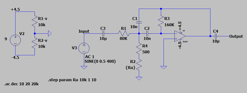

Solder the prototype PCB with al the components as shown in the schematic.
Solder female header cable's on the jack inputs and on the potentiometer.
EDIT: i've added a view of a idea for a breadboard implementation. I hope it helps. I've got some questions about the TO-220 package with two ceramic capacitors. This is a LM7805 with two couple capacitors. this is for the use of a MCP6002. The TL972 works with +9v but the MCP6002 can only handle a maximum of +5v.
