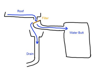

- I detached my downspout from the roof guttering, and attached it about 50 cm lower. I obviously had to remove the same amount of pipe from my downspout.
- I attached my rainwater funnel (the big black plastic bowl looking thing) into the downpipe to gather the runoff. You can use any old bowl to do this, just make a hole in the bottom, and attach it to your downpipe. If it's a plastic bowl, I would recommend using a hot air gun to melt the bottom to match inner diameter of the pipe.
- I added the diverting pipe. I made it by adding a 45 degree angle to a pipe. Your harvesting surface should be a bit bigger than the size of your downspout, so if your pipe is the same size or smaller, you can attach a funnel part to it to increase the water inlet size.
- Finally I attached the pantyhose. You can use any old wire or string to keep it in place.
Step 2: How It Works
When water comes down from the gutter, it enters the harvesting pipe. If there is debris in the filter, the incoming water cleans the debris and it falls into the vat, and is delivered where your roof water would normally go.
When your water tank is full, the rest of the water automatically goes down the drain, if you've attached the harvesting pipe to your water barrel at the correct level. I didn't have that option, so my barrels also have an extra pipe that the water flows out if the tank is full.
