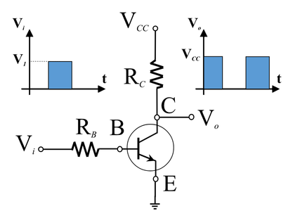

NPN Transistor as a Switch
A transistor can be used for switching operation for the opening or closing of a circuit. This type of solid-state switching offers significant reliability and lower cost when compared to conventional relays.
Both NPN and PNP transistors can be used as switches but here in this project, we are using NPN transistor.
An ideal transistor switch would have infinite circuit resistance between the Collector and Emitter when turned “fully-OFF” resulting in zero current flowing through it and zero resistance between the Collector and Emitter when turned “fully-ON”, resulting in maximum current flow.
In practice when the transistor is turned “OFF”, small leakage currents flow through the transistor and when fully “ON” the device has a low resistance value causing a small saturation voltage (VCE) across it. Even though the transistor is not a perfect switch, in both the cut-off and saturation regions the power dissipated by the transistor is at its minimum.
In order for the Base current to flow, the Base input terminal must be made more positive than the Emitter by increasing it above the 0.7 volts needed for a silicon device. By varying this Base-Emitter voltage VBE, the Base current is also altered and which in turn controls the amount of Collector current flowing through the transistor as previously discussed.
When maximum Collector current flows the transistor is said to be Saturated. The value of the Base resistor determines how much input voltage is required and the corresponding Base current to switch the transistor fully “ON”.

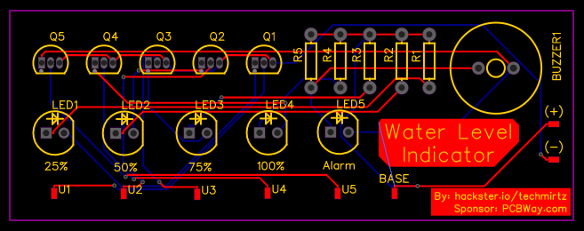

Step 2: Putting All the Stuff Together
Follow the below steps to assemble the device at home easily:
  • Download the Gerber files for the PCB from here.
  • Go to PCBWay.com and upload the files get your PCBs at home at a very low price. Also, you can get a $5 Welcome Bonus. They are the most cost-effective and quality-oriented PCB manufacturers. You can order your prototype PCBs in a small quantity, as small as 5 pcs of PCB. In addition to the standard PCBs, we could also support advanced PCBs, FPC/rigid-flex PCBs and other related services.
  • Solder the components on the PCB as per the schematic and design shown below.
  • Now, you can connect the probes as per the labels on the PCB to different depths. Probes are nothing but wires connected to the board.
  • Put the BASE probe at the bottom of the tank.
Note: If the tank is made up of metal, make sure that probes(bare wire) aren't touching the tank. Else, it can give you a false reading.
