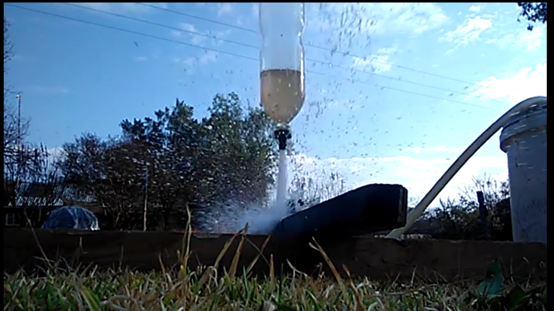

Step 1: Flight Videos
here is a flight video

Now your rocket is ready to launch. Choose a launch site, which is far away from houses, streets, trees and power lines. Secure your launcher to the ground, and attach your air pump to the hose system. Fill the rocket ~1/3 full of water, and put the rocket onto your launch pad. You should raise a part of the hose above the water line in the rocket to stop water flowing back into the pump.
All you have to do now is build up the pressure with your air pump. Please be careful, and always wear safety goggles. Don’t try to use too much pressure, 5bar (70 psi) is enough for your first try. You can use more pressure later, but always be aware that the bottle can explode.
As soon as you have enough pressure, just pull the string and the rocket will launch.
