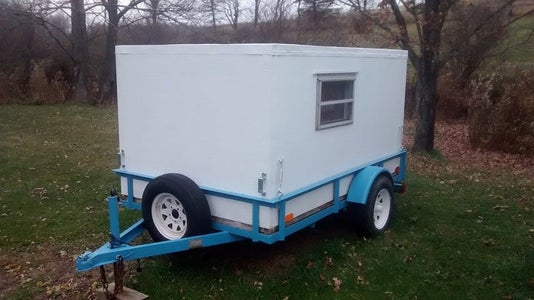

I built a little micro camper (see my other instructables) and I needed a way to carry a fairly large amount of water easily. So I carry it in a tank on top of my camper.

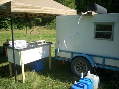

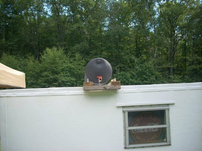

I had already built a water tank system previously. It is a galvanized water tank fastened to a frame that sits on top of my micro camper. It is strapped down with ratchet straps when I travel, I can remove it when not needed, and it allows for gravity flow for ease of use. It is a pretty handy system, but I found it to be too small for a long weekend.

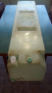

I went to the parts store (a 53' van trailer that I have that is full of camper parts) and picked out a water tank out of a camper I had previously torn apart for parts.
This 30 gallon tank is lighter and bigger than the old galvanized tank.

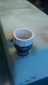

Step 3: Converting the Fill Spout

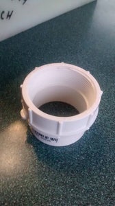

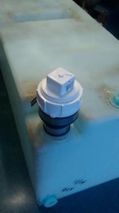

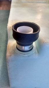

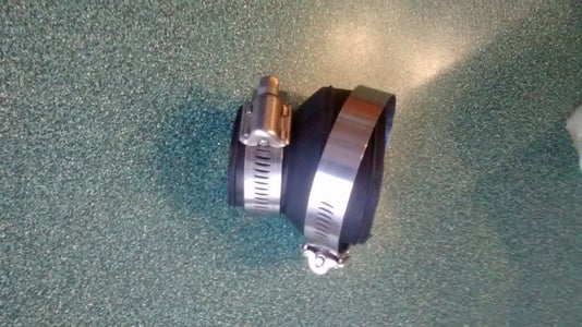

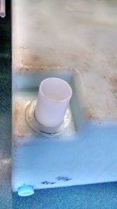

The existing fill spout on the tank is a 1.25" poly pipe extension. Some adapters were needed to make it work for my purpose.

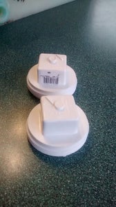

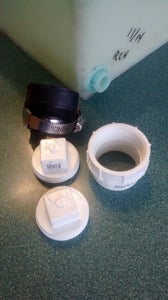

I attached a 1.25" to 2" Fernco Fitting to the tank fill spout, then a 2" threaded fitting was slid into the Fernco fitting, A couple of caps were added to close the tank...

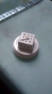

One cap I use when in transit to keep the tank closed, when I get to where I am setting up, I use the other cap that i drilled holes in, to allow air into the tank so the water can drain correctly.

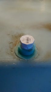

Step 4: Plug Any Unneeded Holes

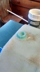

The tank I salavaged had a hole I did not need so I plugged that hole.

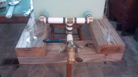

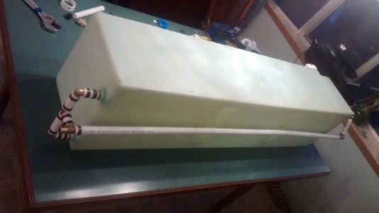

Step 5: Adding Water Lines and Valves to the Tank

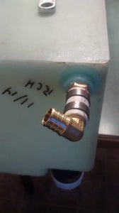

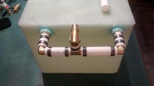

I quit using copper or PVC several years ago... Nothing beats PEX in my opinion.. It is flexible, can withstand freezing, and it is very rugged.

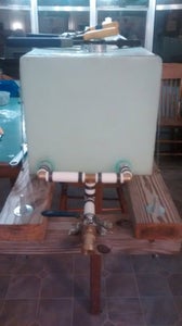

The first thing I did was install 1/2" threaded male to PEX fittings in the bottom openings of the tank... This tank had 3 openings on the bottom, 2 on one end, 1 on the other end.
On one end of the tank I connected the two openings, and ran a T to go under the tank, this will allow the water to drain if the camper is off balance left to right or front to back.
The long pipe connects the two sides so that I can pull water from either side.

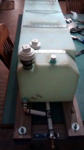

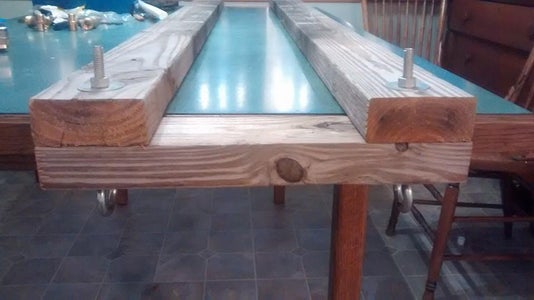

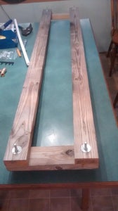

Step 6: Attach the Tank to the Frame

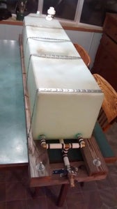

I strapped the tank to the frame I had previously used..
Step 7: Some Final Thoughts...
The water tank works nice because I can pull water from either side of the camper.
The tank is much lighter than the previous galvanized tank when empty, which makes it easier to set on top of the camper.
Now I have 30 gallons of gravity fed water available when camping...
