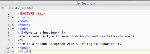

Step 2: Make an HTML File, Save It, Open It
Now open a new file using the text editor you just installed and copy/paste the following into it:
<!DOCTYPE html> <html> <head> </head> <body> <h2>Here is a heading</h2> Here is some text, with some <b>bold</b> and <i>italic</i> words. <p> Here is a second paragraph with a "p" tag to separate it. </body> </html>

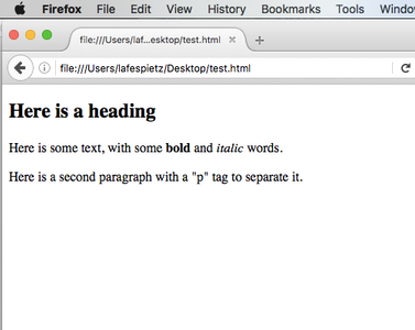

After you copy this into your text editor, save the file "test.html" somewhere you can find it such as your desktop. Now open this file with a web browser by just double clicking on it, which should open it in your default web browser. It should look like what you see in the screenshot of my browser(Firefox). I have also included a screen shot of the text editor to show what the highlighting looks like.
You have now made an html file! This is the most important leg of the three legged stool that is html+CSS+JavaScript.

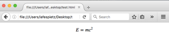

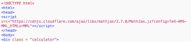

Anyway, as before, we'll do a copy/paste example. Now, go back to test.html and change it to:
<!DOCTYPE html> <html> <head> <script src="https://cdnjs.cloudflare.com/ajax/libs/mathjax/2.7.0/MathJax.js?config=TeX-AMS-MML_HTMLorMML"></script> </head> <body> $E = mc^2$ </body> </html>
Note the changes. First we added a line with a long URL. This is the remote resource that has all the vast amount of information required to make a pretty looking equation. It can be installed locally in theory but I think it's much easier to just use the remote resource since it's constantly being updated. "cdnjs.cloudflare.com" is a third party site that the MathJax people use to host the code since the bandwidth used for this is large in total(it's on a very large number of sites, some of which are huge).
The other thing I added was the equation itself, which will be part of the final calculator. It's just the equation in a simple and familiar format with the carrot "^" representing the power, between two dollars signs. The double dollars sign both converts to math mode and sets the equation apart from all other text, centered on its own line.
More information on MathJax can be found here:
Check it out. It's awesome. If nothing else I would argue that the existence of MathJax means that a lot of what we do in straight LaTeX should be converted to HTML and use this instead of compiling to pdf, but that's a whole other story. I've included screenshots of the sponsors and partners of MathJax, and it's a sort of who's who of people doing huge math things on the Web. That's important because it's why I feel it's ok to rely on for archival quality published work--this software resource is here to stay because numerous separate and well funded groups are all working on it, all in the open.

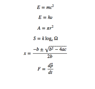

Anyway, save that file, and reopen test.html and you should see the properly typeset equation as shown in my screenshot. Try this again with some other equations such as:
$$E = mc^2$$
$$E = h\nu$$
$$A = \pi r^2$$
$$S = k\log_e{\Omega}$$
$$x = \frac{-b \pm \sqrt{b^2 - 4ac}}{2b}$$
$$F = \frac{d\vec{p}}{dt}$$

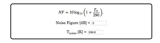

This is it! You've now made, by copy/paste, a working calculator. If you change the numbers and hit "enter" it should update the other number. Note that the number of Joules is so high that you probably have no intuition for that level, which is an odd thing about that being the most famous equation ever. If you want to try changing some part of it, just edit the main expression, which I marked in the comments. Be careful if you change names of things to keep capitalization consistent since everything is case sensitive.
