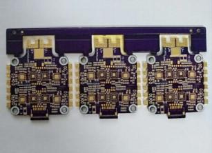

You can also replace this open circuit with a simple PCB, Complete your electronic projects in the best way from PCBWay
Why them? They have provided me with the best PCB, and the quality is just amazing compared to other providers in the market. They also have Color PCB printing check it out
They are now offering crazy discounts if you are using their 3d printing service, For prints over 64g, the discount is equivalent to 20%–80% grab it here
A revolutionary solution that combines the best of both rigid and flexible circuitry to elevate your electronic projects to new heights.
They also offering great prices for purple soldermask, As you know purple pcb are very expensive but not anymore, Check this out.
PCBA & Online quote available with 24hr delivery services
Their expertise in advanced manufacturing techniques offers seamless integration of rigid and flexible components, ensuring enhanced reliability, durability, and space-saving benefits.

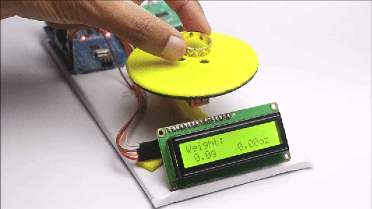

I will be powering this weighing scale using USB power source from a power bank, Just connect to uno board and the display shows some welcome messages.
Allow some time so that the LCD shows 0 and nw place the objects whose weight you want to measure.
To confirm if everything is working fine i placed the object whose weight was already known, I kept gold ring whose weight was known so in this was i was able to calibrate to correct value.
Then again i started placing objects that i found around me and cross checked its actual weight.
To my surprise this device gave me great results and i would recommend you to make this if you do not have a scale at your house.
