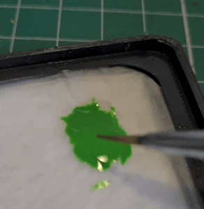

Step 3: The Important Bit
Let's make this a palette!
If using Tupperware: I would suggest using the lid as the palette and what is normally the bottom of the box as a lid. The lid is nice and shallow and won't get in the way of your brushes whereas I can imagine reaching into the box every time you need paint could get irritating.
  • Take a couple of sheets of kitchen towel (you may need more depending on brand and the size of your palette)
  • Fold the sheets in half in one direction, then fold it in three in the other direction - this should fit just right in your palette if you're using my design but adjust for your needs. (pic 1)
  • Take your insert (or the base if you're not using one) and draw around it onto your parchment paper (pic 2)
  • Cut out the shape you just drew (if you used the base, cut just inside the lines to make sure it'll fit inside the palette)
  • Wet the kitchen towel (you can just pour or spray water onto it) then allow any excess to drain out of the box by simply tipping it up on one corner until no more water drains out.
  • Place the parchment you cut earlier on top of your wet paper (ensure it's shiny side up!) (pic 3)
  • Fit the insert on top. (pic 4)
You may need to adjust your kitchen towel a little to fit just right but do try to do this before adding the paper and try to keep everything flat otherwise you'll have wrinkles in your palette - not the end of the world but annoying to work around.

It should make a big difference, your paints will now stay wet for hours, if not days rather than just a few minutes.
Obviously it won't last forever - you'll need to replace the parchment paper and paper towel whenever things start getting a bit worn out.
Given you've got yourself a big boxful of wet, there's always a chance things will get a little mouldy if you leave it sitting around too long as well - using distilled water can give you a bit more time before that happens and I've also heard of people putting pennies under the paper towel or adding a few drops of vinegar to their water as it apparently kills the mould. I find just cleaning it out between projects is plenty - I've not found any mould yet. :)
