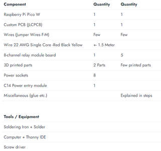

The Figure shows all the Components and Tools needed to complete the project. Most of the components should be available on AliExpress or your local electronics shop in your area. The custom parts like the PCB and 3D Print case will be given below in other steps.
