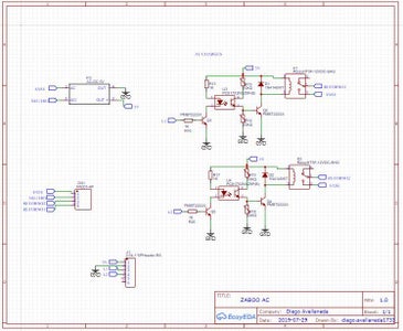

Step 2: SCHEMATICS
Let's talk a little about the circuit, the schematic is developed in EasyEDA (if you don't know it, it is an excellent tool with which you can have your circuits in the cloud and make modifications from any device).
In the first circuit, you can see the necessary connections to operate the ATMEGA328P, with an 8MHZ crystal so that we can handle it at 3.3V (this to maintain the logical levels of communication with the ESP32).
We have as inputs the touchpad managed by a TTP223 and ISP pins to load the firmware from Microchip Studio.
Communication via UART with the ESP32, which also has the outputs as input.
The ESP32 outputs an RGB LED to indicate the status of the connection, whether it is as a client or as an AP.
The design is modular, that is why you see two schematics, the second is responsible for feeding the circuit from 110 VAC - 220 VAC and turning on the relays.

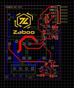

Step 3: PCBs Design
In this step, we see the design of the PCB, as I told you before, the design is modular and the idea is that you can replace it with your old and boring manual switch. This has the measurements of the standard switch box and with that design, you will have no problem locating it.
