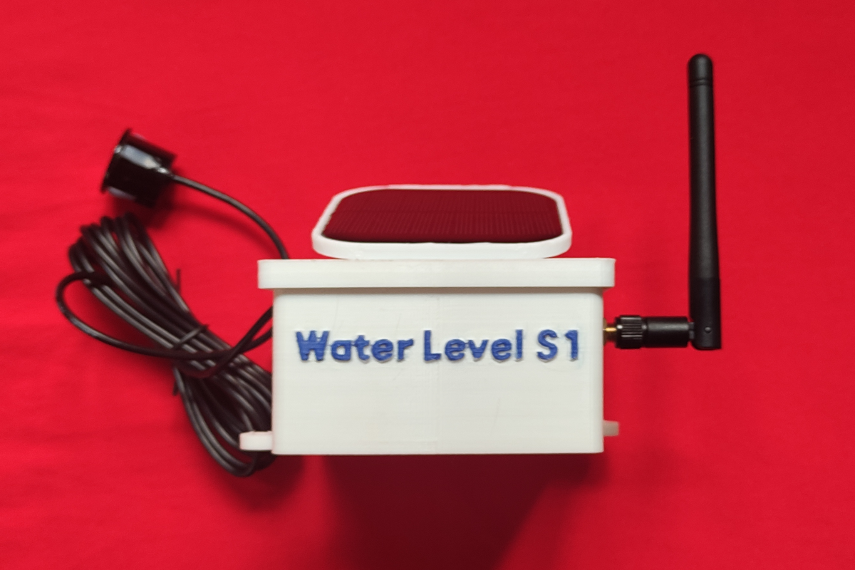

  9. Water Level Monitoring (Essential for Automation):
  10. The Water Level S1 Sensoris crucial for automating the water pump based on real-time water levels. It triggers the pump to turn on when the water level drops below a specific threshold and turns it off when the desired level is reached. Additionally, features like Dry Run Protection rely on this sensor to detect low water levels or lack of flow, ensuring the pump operates safely and efficiently
