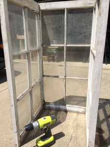

Step 1: 4 Windows Is All You Need
Locate 4 windows. They do not all have to be the same but they do have to be fairly close to size. These are old and antique, so do not spend a bunch of time trying to square each side and angle. Simply screw three of the windows together in a "U" shape and you almost done.

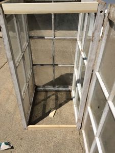

Step 2: Support and Door Frame
Next Support your three windows with adding to boards across the bottom and the top. This will keep them "square" to one another, while providing a support, and a frame for your door to close on. Also you will be screwing your roof joist to the top board as well.

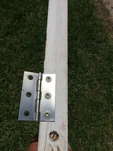

Step 3: Hing Your 4th Window
Hinge your 4th window and this is now a swinging door. The hinges will go on an adjacent side, it is entirely preference with which way you want the door to swing open.

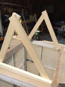

Step 4: DIY Roof Joist
You will need to create the form for your roof. I wanted it to peak, and leaving the front face and back face of the roof open for future planning I'll share later on.
To create the roof, I screwed one wood screw (could also use a machine bolt with nut and washer) to the pivot point of two 1x2 pieces of wood. Taking each end (opposing the pivot point) attach the base of the joist to either the back window or the front support boards. Now you have your joist its time for a roof.

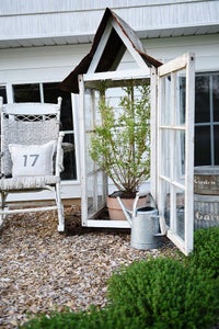

Step 5: Antique Tin Roof
I found some antique rustic tin ceiling tiles at a local antique store. I didn't have to cut it as I like the little flare at the bottom of the roof. I used Finishing screws to attach the roof to the joists and my roof was complete!
Put the DIY Window Greenhouse where you want it, stick a plant in it and your done!
+The future plan for this green house is to nail in chicken wire into the opening and across the top. Try to get some vine type or succulents to pour out the top!
