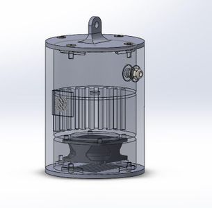

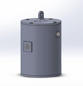

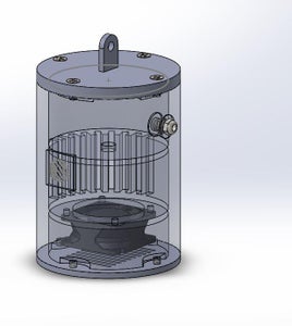

I encountered a significant challenge: the accuracy of the environmental sensors was compromised by direct sunlight and the humid conditions of the greenhouse. Direct sunlight caused the sensors to overheat, leading to erroneous temperature readings, while the high humidity levels posed a risk of damaging both the sensors and the PCBs. To overcome these obstacles, I turned to custom designing in SolidWorks. My solution was a specialized sensor case, equipped with a 12V fan to ensure consistent air circulation. This design effectively shields the sensor from direct heat impact and mitigates humidity concerns, allowing for precise and reliable measurements of the greenhouse climate. This innovation not only enhanced the performance of the sensors but also significantly increased the longevity and reliability of the entire system.

3d Design and Printing

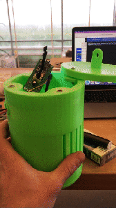

Step 5:
Assembly
