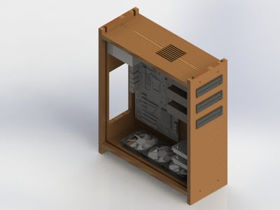

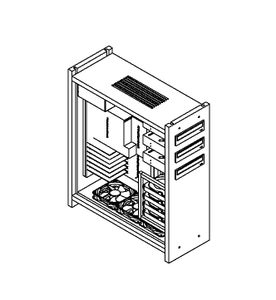

Step 1: Basic Shape and Air-flow
After I knew about what I wanted the case to look like I started making a basic tower shaped case. At this point I had to start thinking about cooling. I didn't want fans on the sides or the top and there wasn't room on the back plate. My only option left was to put them on the bottom. This actually seems like it was my best option anyway. The fans will pressurize the case, pushing the air out the power supply and the vent at the top.

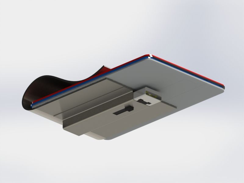

Step 2: Download the Standard Parts
After I had the basic shape I needed to get all the standard parts in the case to make sure there was plenty of room. I could have manually drawn each standard part or I could just head over to GrabCad and download a file for all the standard parts.
Step 3: Assemble All the Parts and Make Any Final Changes.
The last step is to assemble the parts and make any changes that are needed. For example I originally had my case to skinny. The CD bays had zero tolerance and would have needed to be pressed into the case. I was able to simply had an extra half inch to the width of the case to make room for it.
