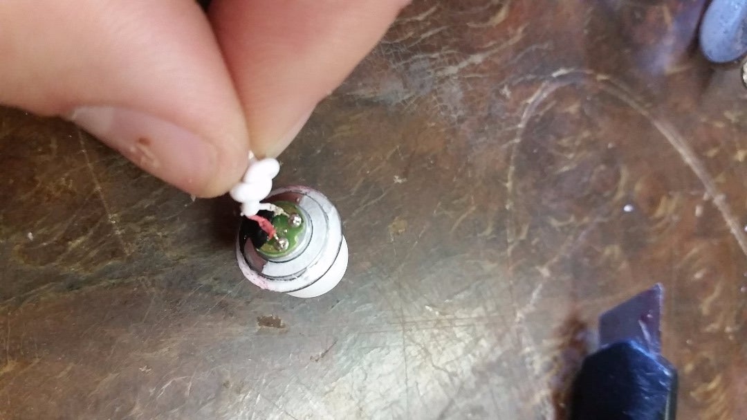

Time to open up those buds! Grab your X-Acto knife and pry along the seams of the earbud housing where the white part meets the silver. These guys really don't want to come apart, so don't be afraid to use some force. I found that it was easiest to open them but cutting in between the speaker and housing and working my way around the entire earbud.
Once you have the speakers separated from the housings, take a picture of the wiring before de-soldering the wires to note the polarity. This will ensure everything works perfectly once you put it all back together!
After de-soldering the speakers, undo the knots in the wires and remove the old plastic housings! Next time we assemble this we're gonna have some beautiful wood housings instead :)

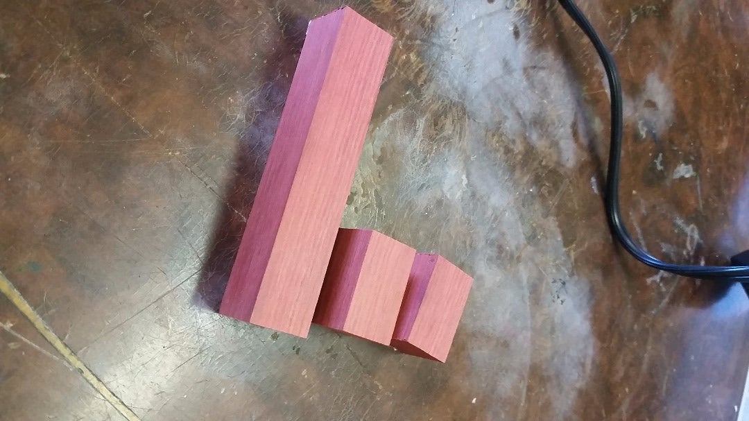

Step 3: Cutting Wood to Size
This step is pretty self-explanatory, we need to cut the wood to size. This doesn't need to be exact at all. Since I'm making my earbuds the same size as the original housings, I eyeballed the length and cut it on the chop saw. Any saw will work for this, I just used the chop saw because it's the quickest way to cut the pieces to size. You should cut two pieces of the same length, one for each housing. Err on the side of making the pieces a tad longer than the original housing, just to give yourself some room to work.

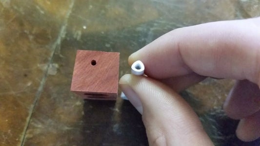

Mistake #1:Drilling too close to the edge of the block
Since the top of the block is the end grain, it can come apart very easy if you drill too close to the top (See pic #1). You can avoid this by drilling slowly so that the bit doesn't catch or by simply drilling a hole lower on the block. I made this mistake, and there's no real fix for it, you'll need to cut a new piece.
Mistake #2:Drilling too far for the wire
To make a hole for the wire to go through, you have to drill a hole through the bottom of the block. This can be hard to measure, and when using a tiny bit you can make a deep hole quickly without realizing it (Pic #2). I made this mistake too, and the worst thing is you may not realize it until you're already part of the way done with sanding. Unless you're ok with having a hole in the top of your earbud, you'll have to either patch the hole, which probably won't look great, or start over with that housing. To prevent this, drill slowly and check the depth of the hole often. To check the depth, insert a bit smaller than the one you used to make the hole and put your finger where it stops in the hole, then take it out and measure it against the outside of the wood (See pics #3 and #4 if that wasn't clear enough).
Mistake #3: Drilling too close to the side of the block
This one's pretty simple, don't drill too close to the side of the block (Pic #4). If you're not lazy like me, find the center line of the block and drill on that line. Otherwise, just eyeball where the center is and make sure the drill doesn't wander off-center.
Mistake #4: Sanding too much
When sanding the earbud into shape, it can be very easy to sand too much and make the part surrounding the speaker too thin. Since this wall is so thin in the first place, go slowly and check the wall thickness often by inserting the speaker into the housing. I made a pencil mark outlining the speaker so that I knew where to roughly sand the earbud down to (Pic #5). It isn't the end of the world if you sand the housing down too far, but the outside won't be flush with the speaker, which can cause some discomfort and won't look as good.
There are a lot of variables with this project, especially since it is all done by hand. Going carefully and triple-checking your cuts and sanding will eliminate most sources of error. There is a huge sense of accomplishment once you finish a handmade product, it's what I love about this kind of project! Working through your mistakes is what really makes you better and the reward is definitely worth it, so push through it!

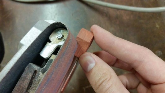

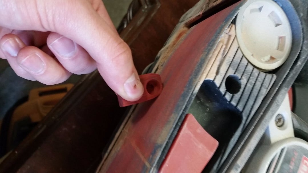

Next, outline the outside of the speaker on the wood. Then, using the belt sander, sand the sides of the block down to the mark on each side. Also sand the back of the block down so it is close to the hole you made for the wire to go through. Round over the top by rotating the block on the sander to achieve the rough shape that you want.
Once you have the top and sides sanded, use the tip of the belt sander to roughly shape the bottom of the housing. Make sure you leave plenty of wood around the hole for the wire on the bottom so that you don't accidentally sand through the hole. Use the tip of the sander to get the basic shape of the front of the speaker cup as well.
To get the sharp cutoff on the bottom part of the earbud cup, I used the edge of the belt sander. This was much easier than trying to get that sharp corner by hand, which would've taken a lot longer. I got the initial shape by using the tip of the sander and then used the edge to make a sharper cutoff.

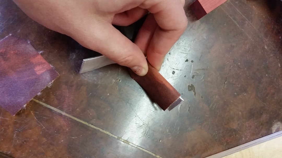

Take a smallish piece of sandpaper and the piece of flat aluminum bar. By folding the sandpaper around the aluminum, you can make a great tiny sanding block! It's perfect for this project since the earbuds are so small and require a lot of fine sanding. Sand the earbud down into the shape that you desire, in my case I tried to make the new earbud look as much like the old one as possible.
Remember to constantly check to make sure you aren't sanding too much! Place the speaker in its hole often and see what else needs to be sanded.
To make the part below the cup circular, I just folded a piece of sandpaper in half and spun the earbud while holding it in the crease of the sandpaper.

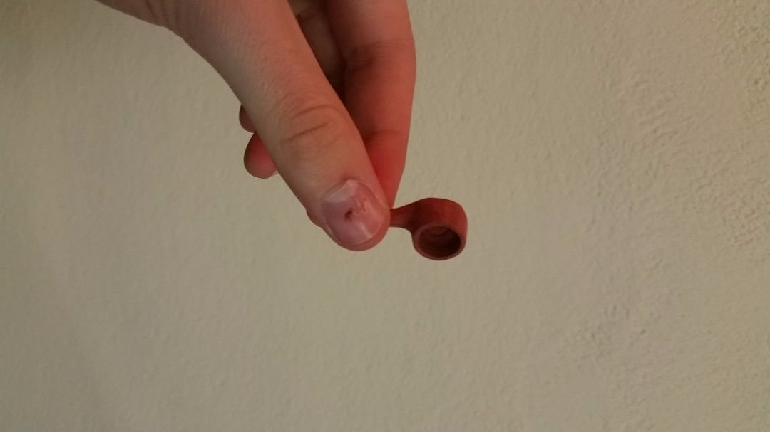

Keep sanding with the sanding block and/or however else you think would work best! Round over the back of the housing and make sure it all looks smooth and has a constant curve.

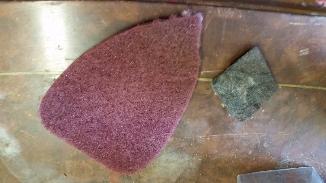

Start by using the #0000 steel wool to "sand" out any imperfections in the earbud: sanding lines, high spots, etc. You will need to polish the earbud a lot to get it to a nice sheen. Also use the finishing sponge to clear away any dust or debris that may have settled onto the earbud. Once you have made the earbud smooth and reached a nice sheen with just the natural wood, its time to move on to the finish!

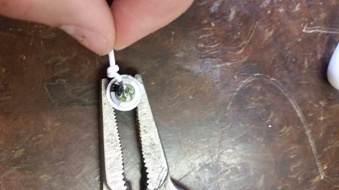

First, thread the speaker wire through the earbud and pull it out of the speaker hole. Here is where you will choose which housing goes on which side, so take care to make sure each housing is on the side that you want it to be on!
Next, secure the speaker so that we can solder the wires back on. I just used a small vice grip to hold the speaker.
Now, check back at the pictures you took when you disassembled the earbuds to check the polarity of the speakers. If you didn't its not that big of a deal, but its just better to have things put back the same way that they were.
Once you've determined the correct polarity, its time to solder on the wires! Since the speaker contacts and the speaker wire were already tinned from when I removed the wires, there is no need for any solder at all! Just heat up the wire and contact and they should solder together beautifully.
Now that everything is soldered together, make sure to test the earbuds to make sure they work! Plug them in to your phone or laptop and check to make sure sound is coming out of both earbuds. If not, check your soldering and try again! Once you get both speakers working, you can continue.
Tie a knot at the top of the wire next to the speaker now. This is to provide stress relief on the soldered wire when it is yanked on or gets caught on something. It would be a shame if the wire simply pulled out of the earbud after you've glued it all up!
Once you've tied the knot, pull the wire back through the earbud so that you can test fit everything before gluing. If everything fits together well, then you can glue it all up!
Step 11: Success!
Congratulations, you now have the coolest DIY earbuds ever! I think these earbuds look great, and I've already received tons of compliments on them! I have yet to find out how well they hold up to lots of wear and tear, but they seem to be very sturdy and should hold up for a long time. Have fun showing them off to your friends and watch them gaze at your amazing craftsmanship as you look on with satisfaction (just kidding you don't have to boast). Most of all, have fun listening to your favorite tunes through the earbuds that you just built yourself!
