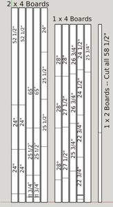

Step 2: Measure and Cut Boards to Length.
Using a pencil, measuring tape, and the carpenter square, mark each board according to the lengths listed below. See the picture for how to mark the cuts to maximize the use of the wood.
- Cut the 2 x 4 boards to the following lengths
- 65" (x 2)
- 24" (x 5)
- 25 1/2" (x 4)
- 11 3/4" (x 2)
- 52 1/2" (x 2)
Cut the 1 x 4 boards to the following lengths
- 22 3/4" (x 2)
- 24 1/2" (x 2)
- 25 3/4" (x 2)
- 26 3/4" (x 2)
- 27 1/2" (x 2)
- 28" (x 4)
Cut the 1 x 2 boards to the following lengths
- 58 1/2" (x 10)
TIP: Write the length on each board before cutting, as many of the boards are very close in length. Labeling the length of each board will eliminate confusion later.
When you are done cutting you should have the following boards:
- 5 Swing seat support boards (24 inches long)
- 2 baseboards (65 inches long)
- 2 vertical arm rest support boards (11 3/4 inches long)
- 2 vertical back support boards (25 1/2 inches long)
- 2 horizontal back support boards (52 1/2 inches long)
- 2 arm rest boards (25 1/2 inches long)
14 Swing back slats (All the 1 x 4 boards)
10 Seat slats (All the 1 x 2 boards)
To avoid confusion, these names will be used to refer to these boards throughout the rest of this Instructable.

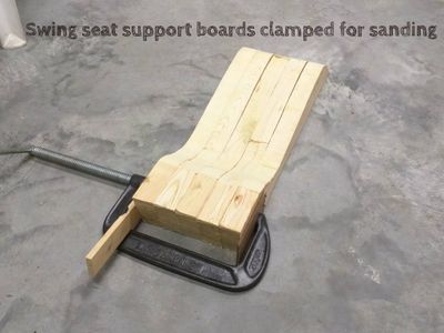

Step 4: Clamp and Sand Swing Seat Support Boards.
- Line up swing seat support boards using the tip and the bottom back edge.
- Use two thin scraps of wood and a C clamp to clamp the five swing support boards together at the back (angled section) of the board. The scraps of wood keep the C clamp from leaving a mark on the outer 2x4s.
- Using the random orbital sander, sand the swing seat support board curve until there is a uniform curve across all five boards.
- When the curve is even across the five swing seat support boards, move the clamp to the middle section and be sure to sand the back angled edge of the 2x4s smooth as well.
- Before removing the clamp, number the boards 1-5 from one end to the other. Because they were sanded in that order, the same order will make the most even seat when assembling the swing.

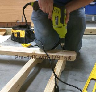

Step 8: Attach Swing Seat Support Boards #1, #3 and #5 to Rear Swing Baseboard.
- Lay swing seat support boards #1, #3 and #5 on the ground, curved side down.
- Line up the outside of support board #1 with the first line on the baseboard, also lining up the back of support board #1 with the back of the baseboard as pictured. (The back is the angled cut!)
- Line up support board #5 in the same way on the opposite end of the baseboard.
- Line up support board #3 with the 1 1/2 inch section marked in the center of the baseboard, again lining up the back of the support boards with the back edge of the baseboard.
- Use the 1/8" drill bit to pre-drill two evenly spaced holes through the baseboard into the first swing seat support board. Use this same drill bit to pre-drill for all screws used in the assembly of this swing. Pre-drilling helps to ensure that the wood doesn't split while inserting the screws.
- Use the electric drill/driver with the Philips head driver bit to insert 3 inch exterior screws into each of the pre drilled holes. Make sure all screw heads are flush with the surface of the wood, not sticking out above the surface.
- Repeat for the other two support boards.
- Complete the pre-drilling and inserting screws for each swing seat support board before moving on to the next one.
TIP: If you have TWO drills/drivers, use one for pre-drilling and one for inserting screws. This will save you a lot of time you would otherwise spend switching your drill bit and driver bit in and out.

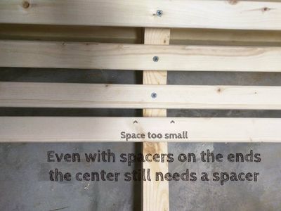

Step 16: Sand and Attach Horizontal Back Support Boards.
- Take the 52 1/2" 2x4 boards and sand smooth.
- On the back side of the vertical back support boards, measure up from the top of the rear baseboard and draw lines at 5 3/4" and 20 3/4".
- Using the square, extend this line onto the inside edge of the vertical back support boards. These marks will line up with the bottom edge of each of the horizontal back supports.
- Tip the swing on its back for this step so it is easier to keep the boards lined up while assembling.
- Place the horizontal back support boards (one at a time) in between the vertical back supports and line up the bottom edge of the board with the marks made on the vertical supports.
- From the outside edge of the vertical back supports, pre-drill two holes, evenly spaced, through the vertical supports and into the horizontal back support boards.
- Insert 3 inch screws into the pre-drilled holes and make sure the screw head is flush with the wood.

- Cut two small chunks of wood 3/4 inches wide to use as spacers for placing the seat slats.
- As each slat is added, inspect the board so that the best side of the board (fewest knots and imperfections) can be facing upward.
- Starting at the back of the seat, place the first slat all the way against the vertical back support boards and line it up with both sides of the bench.
- Pre-drill one hole through the seat slat into each swing seat support board (five holes per seat slat) and insert a 1 5/8" screw into each hole. Insert the screws until just flush with the board.
TIP: If you do insert the screw too far, and the head of the screw is below the surface of the wood, do not remove or unscrew it to make it even. This causes the screw's hold to be weakened.
- Complete all the pre-drilling and inserting screws for each seat slat before moving on to the next slat.
- After the first slat, place the 3/4 inch spacers between each new slat and the slat before it, near the ends of the boards, to hold the spacing. Then pre-drill and insert screws.
- Move the spacers to the center (as pictured) when pre-drilling and inserting the screw into the center swing seat support board, as the spacing here tends to get smaller or wider on different parts of the curve.
