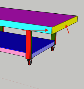

Step 1: Building the Surface
These tables were built 4' x 8' so the first step is taking a 3/4 in plywood piece and outlining it with 2" x 4" x 8'. Use the diagram in the picture above or the Sketchup file to follow the 2" x 4" cutting list. TIP: Use the plywood to determine the cut length of each 2" x 4". This will allow you get everything flush in case the plywood is not perfectly square.

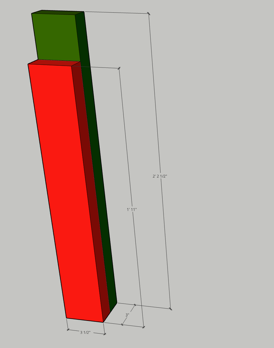

Step 2: Leg Assembly and Installation
I then built all four legs with 2" x 4"s. Use the Sketchup file as for reference. The back tall side of the let is 28.5" high. The front short side of the leg is 25". I then used 4 wood screws to fasten each leg together. Then fasten the legs together with a cross 2" x 4".
Step 3: Cross Beam Assembly
Continue fastening the legs together with 2" x 4"s. Ultimately re-enforcing will come down to your preference. You can keep adding 2" x 4"s until you feel the structure is strong enough to your liking. I can say the route I went resulted in some very strong tables that can glide across our floors with hundreds of pounds on them.
