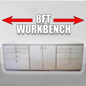

We used ¾” plywood for the carcass and ½” plywood for the drawers boxes and faces. The overall cabinet dimensions are 96” x 28” x 36” (L x W x H)

Step 13: Final Product
Before we had a huge mess with tools and supplies all over the place and now we have this awesome workbench with 8 super deep drawers and some shelf space to give a home to all of our stuff when we’re not using them.
