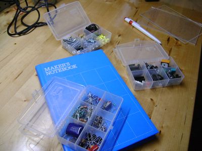

The Power Supply, LEDs and other Electronics
The screen runs off 7.5 V and the NES runs off 5 V. I don't want to be messing about with more than one power supply so I'm going to destribute power from a single adjustable supply. To do so I need to build a tiny Voltage regulator circuits using some ICs.
-For the 7.5 V Power Supply' (Screen)
1x LM350 IC
1x 220 Ohm resistor 5% 1/4 W
1x Stay Set 0-400 Ohm potenciometer
1x 1.2 kilo-Ohm resistor 5% 1/4 W
1x 0.1 uF ceramic capacitor
1x 1.0 uF electrolytic capacitor
-optional-
1x heat dissipator.
"-For the 5.0 V Power Supply (NoaC and LEDs)"
1x 7805 IC
-optional-
1x 1 mF electronytic capacitor.
"Other stuff"
You will need some cable, some 40/60 solder (if you can find leadless better) some screws and a 12 V Power Supply. Off course, you also Need a workbench or workspace to put your stress releasing NES.
