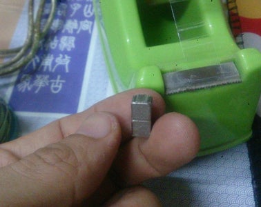

Step 4: Get the Magnet Ready
Find a piece of plastic, here I use a microSD container plastic. Cut a piece of it at the width of the bevel-in side charging connector area (the black oval area). Yes, it is very tiny and need patient working on it.
Simply stick it on the magnet with adhesive tape. This plastic is intended to keep the magnet align in the bevel-in charging connector area, otherwise you need to manually align your pin on the tiny connectors on phone and a little move on the connector will disconnect the charging. Don't worry, neodymium magnet is a kind of strong magnet and it will keep the connectors in place, moreover with this little plastic stay in the bevel area.
The usage of adhesive tape will also prevent scratches on your phone. Try to stick the magnet on your phone and make sure it doesn't move much. Or you can stick the plastic with a stronger glue before laminating it with adhesive tape for anti-scratch.
