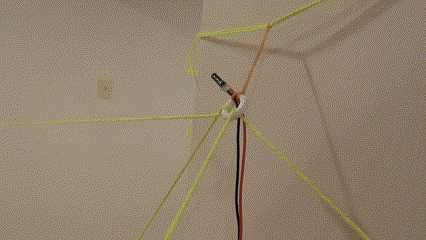

I used vibration sensor switches to detect contact with the yarn. This vibration sensor is a switch that is normally open and closes when vibration is applied. I tried three different sensitivity sensors (fast, medium, and slow) sold by Adafruit Industries. A fast vibration sensor is the best for this project.
The sensor is attached to a ring-shaped hook threaded with the yarn. The ring is fixed to the anchor by a rubber band. The rubber band allows the sensor to vibrate better. Also, when the player gets caught on the yarn, the rubber band stretches, so it doesn't hurt.

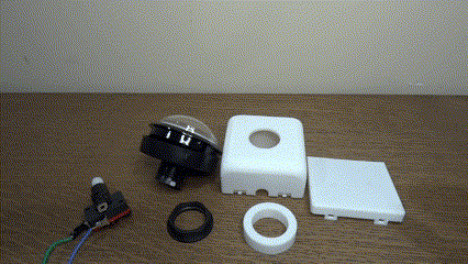

All parts were designed with Autodesk Fusion. The control box and the button case do not require any screws to close their lids.
Download the files and print them. You will need to print five sets of button cases and as many fasteners (anchors and hooks) as you need.

Place the button and the components of the controller into their respective cases and close them.

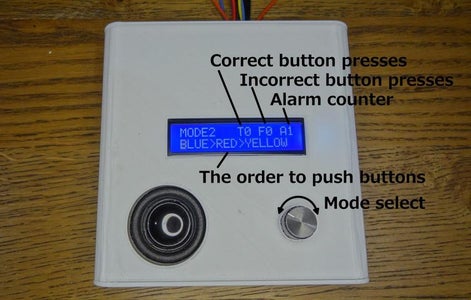

There are eight modes, which can be selected by the potentiometer on the control box. The order to push buttons changes in modes 1 to 6. The 7th mode (random) has the random order. The 8th mode (secret mode) also has random order but the order isn't shown on the display.
The white button serves as the start button. The green one serves as the goal button. The others serve as mission buttons.

- Attach some sensors to the hooks.
Tips:
- Do not divide the yarn mid-course in order to detect contact with the yarn between the anchors without sensors.
- Make sure the yarn is not loose, as this reduces the contact sensitivity.
- Attach a sensor to an anchor where the yarns are concentrated. This can reduce the number of sensors needed.
