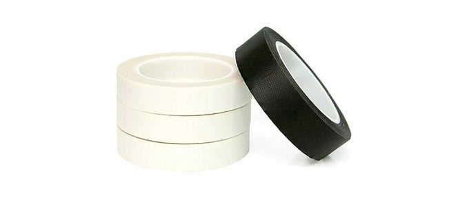

Step 3: Fix Them With Fiber Tape
We place them in order and fix them with fiber tape.
The fiber tape is made of hot melt adhesive and forms a stronger tape that is resistant to tears and has better temperature tolerance than regular tape. It is explosion-proof and leak-proof, providing high-strength insulation protection.

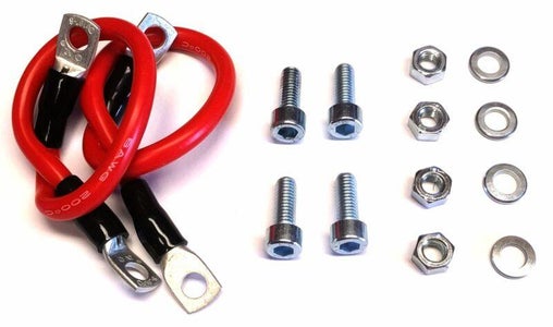

Step 4: Install Signal Acquisition Wires in Sequence With Connecting Pieces
Connect the cells using the connectors in series while connecting the indicator cables to the CPM and the cells. Don’t tighten connectors and nuts too tightly.
