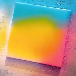

Step 1: Prepare Your Tile
Start by preparing your white tile for the colorful engraving. Spray two coats of different colors on various areas of the tile to create sections of color. Wait for each layer to dry completely before moving on.
Once dry, apply a final layer of matt black spray paint over the entire tile to cover the colors underneath—this will reveal the vibrant layers during engraving.

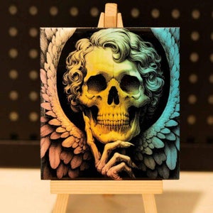

Step 3: Laser Engraving
With the file uploaded, configure the engraving settings in Lightburn: Set the speed to 3000 mm/min, power to 30%
Once everything is set, start the engraving process. The laser will burn through the top black layer, revealing the colorful undercoats in a stunning skull pattern.
Step 4: Enjoy Your Work!
Now you have completed your colorful skull engraving on tile! The speed of 10w diode should be around 2800 to 3800mm/min, if you machine is more powerful, then speed up it. And you can also use black spray for a black and white version or use titanium oxide for assisted engraving
