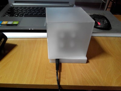

Let's see what Magic Light Box (MLB) is!
MLB is a lighting box that can change the color upon the movment. It is based on Arduino Nano, using tri-axial accelerometer ADXL345 to collect the moving information. Besides, it can be charged by way of wireless charging.
Three Lighting Mode:
Shaking in X direction - White Color Mode
Shaking in Y direction - Auto-changing Color Mode
Shaking in Z direction - Changing upon Attitude Mode

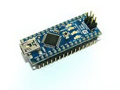

1 x Arduino Nano

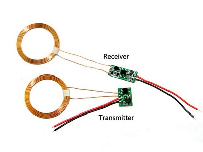

1 x Wirelss charging module

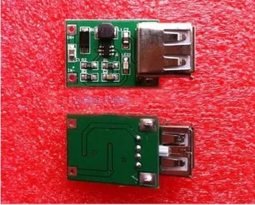

1 x DC-DC 5V boost module

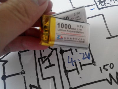

2 x 3.7V lithium ion battery 952240

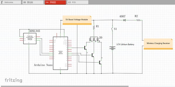

Step 2: Schmatics
R1 = 5ohm, R2 = 10ohm, the value depends on the number of RGB LED.
Step 3: Connects the Modules
Connects the modules based on the schematic.

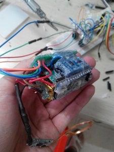

Step 5: Add the Glue to Protect the Circuit and Program
The Arduino Nano is then covered by the glue to avoid the possible short circuit.
Do the same for the other modules.
Then simply tied them with hot melt adhesive. Before that you can cut off some pins on the modules to save space, such as arduino Nano's ICSP pins. Once the work is completed, this Nano is impossible to use again, so, for those unused IO pins, cut them off!
Program to the Nano, and test the functions. Test the charging effect. After doing the above work, this stuff can be put aside.

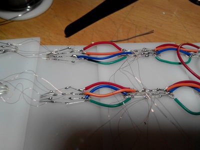

All 20 RGB LEDs are in prallel connection. Be careful the polarity of each LED.
I don't recommend using the colored line on the photo, as the soldering point is easy to disconnect.
The soft fly line is a good choice, as it is able to adapt to the process of enclosing acrylic to the cubic.
Note, the current of single line only allowed 47mA or less. So the part closer to the power should be connected more lines. The lines connected to anode pins should be more than the cathode pin.
Pay attention to confirm the fly line is not easy to fall off, and using a multimeter to verify before the final installation.

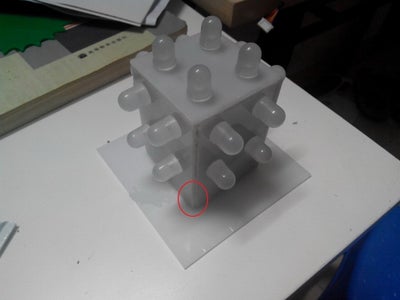

Step 8: Install the Internal Cube
Connect the boards with hot melt glue to get the Internal LED cube done.

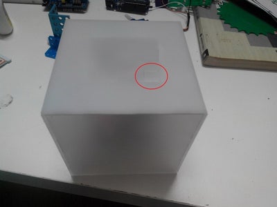

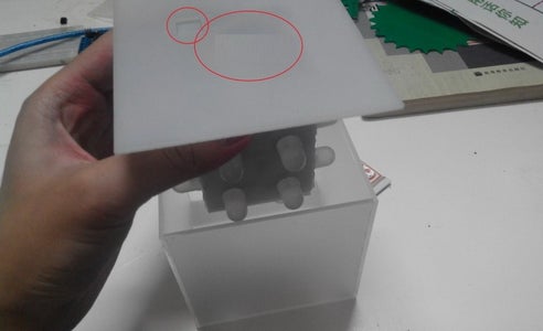

Step 10: Install the External Acrylic Cube Boards
Glue the acrylic boards into a big cube, and install the LED cube into it.
The main body of the MLB is done, and the size is 96x96x96mm
Step 11: Make the Charging Base
It's very easy to make the charging base.
Put the DC connecter and the wireless charging module to the acrylic board.
Plug in the power adapter, and put the MLB onto the charging base, the work is finally done.
