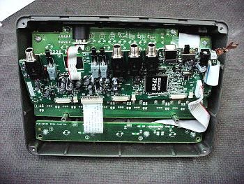

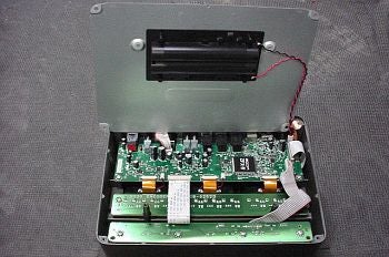

Open the casing bolts under B3 or G3
Step 3: Step 2

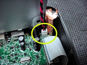

Open the battery cable connections
Step 4: Step 3

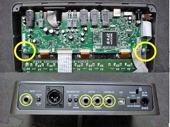

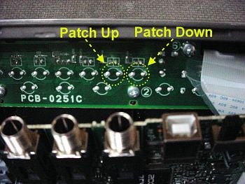

Open the bolt on pcb and jack on the casing , and open the pcb
Step 5: Step 4

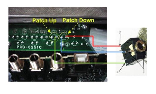

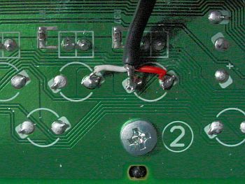

After the pcb open , prepare the cable and solder , then solder the parts shown in the picture , connect the cable to the connector female TRS

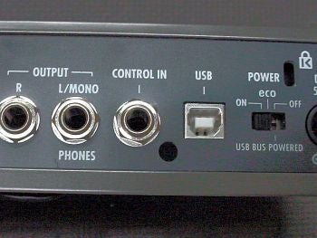

Make a hole using a drill on the chassis, the position is up to you, need to plan exactly, so that not one of the holes and do not interfere with other components

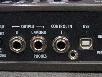

Post a TRS connector on the casing and reassemble your effect , do not forget isolation trs conectornya , not to be connected to ground
