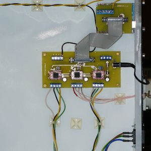

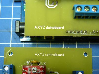

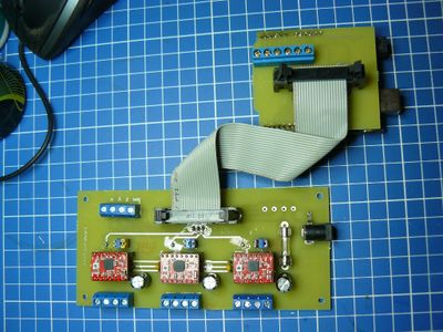

The first difficulty was associated with the ability to easily connect, as all open systems and controlling systems of coordinate machines, which are known to me, are based on the LPT interface. This greatly limited the range of the used computers. The solution was found, I decided to use open software project GRBL based on Arduino. As drivers I used A4988 chips of the company Allegro.

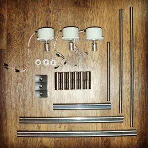

I hastily selected and put together electronics, because at that time I was completely sure that I was late and needed to do everything quickly (how much I was wrong). I got two boards on the well-known components. Now drivers operate in step mode 1/8, soviet stepper motors work perfectly DSHI200-1-1.
3D-printers developed actively and the appearance of the machine was copied from them, which determined the layout of axes and the overall characteristics of the machine.

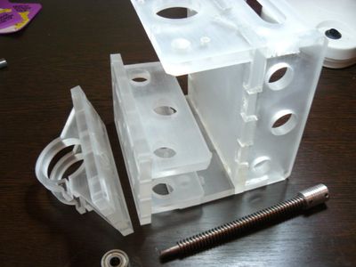

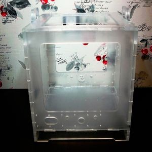

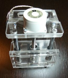

The housing became supporting, the X-axis was fixed and the work table (the Y-axis) moved under it. The Z-axis was combined in a single unit with the carriage of the X-axis. The linear bearings were pressed right into the housing, which greatly saved the cost of the components, but at the same time is does not give a loss in stiffness.
The axes move on the cylindrical guides about 12 mm in diameter with the help of the trapezoidal screw.
When I finished with the electronics, form factor and axes configuration, it was necessary to determine the material from which it was possible to create the machine.
I needed some slab material, which I could simply process, buy cheap and then make easily the machine.
The choice fell on Plexiglas 10 mm thick for the main structure and 5 mm for overlaps.
This material is strong and sufficiently elastic, it is easy to mill or cut with the laser and then glue together and paint it.

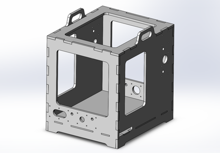

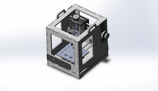

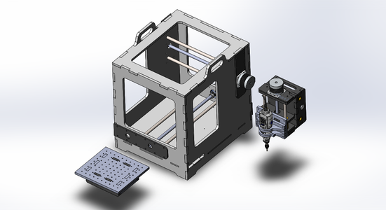

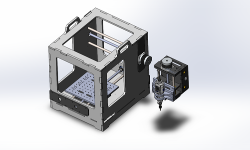

After collecting all my thoughts I started drawing the model and preparing components for production. As a result I got a modular construct adapted for fast assembly and adjustment. All units were designed so as to be maximally “box-shaped”. This simplifies the control of the geometry of the machine and increases the strength of the modules.
Speaking of overlaps, which were cut from the 5 mm thick Plexiglas, they perform not only a decorative function, but also fix the guides inside the housing. This also saves money on parts.

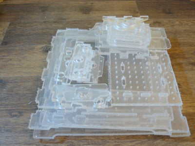

So, after the preparation of the project, the simulation is complete, the purchase of components and preparing files for production took a half years. I ordered milling parts made of plexiglass. Get about 1.5 square meters. meters thick Plexiglas of 10 mm and 5 mm., a total of 27 items.
I decided to glue with dichloroethane because for Plexiglas better than dichloroethane can be ONLY “dichloromethane” – as this chlorine derivatives is more fluid and less toxic than dichloroethane.
“The Glue” is usually made from the same material, which you are going to glue (made from its shavings) – 3-5% by weight and spread “the glue” as thin as possible.

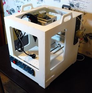

The photo presents the test assembly. If you will matt the Plexiglas, the appearance of the machine will be more complete, but still the machine was painted with the matt white paint.

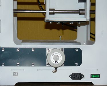

Step 4: General Appearance

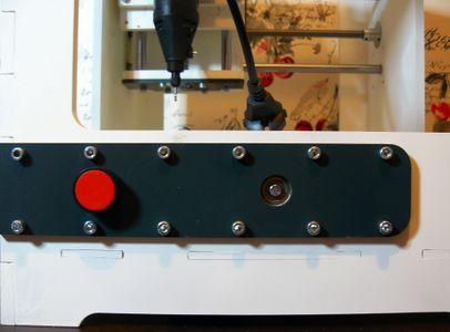

All wiring is hidden within the housing. The electronics is placed under the bottom of the machine (there is no Power Supply on the photo yet), all connectors are on the rear panel.

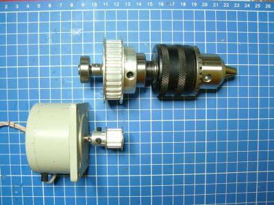

Dimensions of the machine: 365×430×420. Working field: 200×200×80. As the spindle I decided to use an inexpensive Chinese engraver with a capacity of 125 watts, which is enough to machine the plywood, plastic, engraving PCB.
