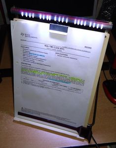

Well the idea of this DIY came to my mind when i wanted something to hold my papers onto a stand where i not only can easily read it but also have a line marker to know where i was earlier.I am an electronics hobbyiest and is working on electronics projects where you have to consult datasheets all the time for the particular components.Thus the idea of a "COPY HOLDER" came to mind.I didn't had this already or ever thought of buying one. I found a copyholder in a dumpster dive and it was in a good condition except the stand was broken and needed a fix.
Then i thought why not add a strip of LED lights to it so that it will very handy in low room lights or when working at night times.I also added a NE555 based brightness control circuit to it so that i can adjust the brightness according to the taste of my eyes and it also has a basic 5V USB outlet so that you can charge your mobile phones,etc on the go.The copyholder back has also been provided with a plastic container box that can be used to place your mobile phone.etc while charging or any other stuff you like to.

Step 8: And You Are Done!!
For powering the device you can directly connect it to a 12v wall adaptor or 12v a solar panel.
Thus continuous power all the time for the copyholder and also charge functionality for your gadgets using solar power.
