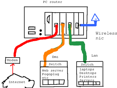

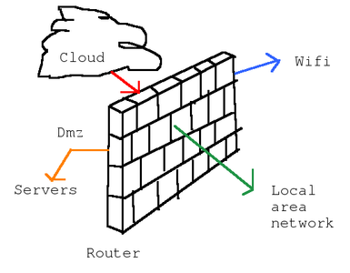

What we want to do is isolate our home network from the internet. The router we are building provides that protection. But there are several ways we can connect. The simplest has two parts one cable (known as the red network) goes to the internet and a second cable (known as the green network) goes to your home network. pfsense profides all the software to allow this to happen. You could also have two additional networks. one for wifi (the blue network) so it can be independent of your wired network and then one for the orange (DMZ or demilitarized zone) network for devices acting as servers that need direct access to the internet. for our purposes, we will just set up the red and the green network.

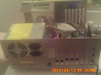

Step 2: What's Needed.

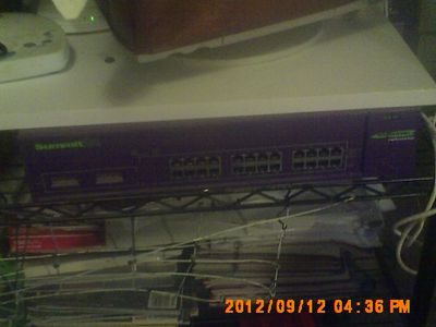

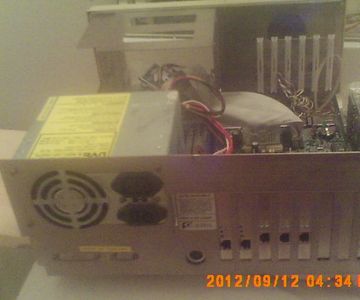

For your basic router you will need at least two network interface cards (aka nics) , a computer (an old pentium 1 at least 100 mhz/128mb ram with at least two pci slots. An old hard drive with at least two gigabytes or a compact flash card with ide interface. Possibly a switch for connecting multiple computers to the router. If you are only connecting to one computer then you will not need a switch. Lastly you will need the pfSense router software. You could probably go to a neighbor's house and quickly download the firmware to a cd. (http://www.pfsense.org/index.php?option=com_content&task=view&id=43&Itemid=44).
There are several versions, but I chose the 2 gigabyte version to fit on the compact flash card.
Hint: before installing the network cards be sure and write down the mac addesses (xx.xx.xx.xx.xx.xx) of the cards and the order they are in where they are plugged into the computer.

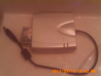

Once the image file is extracted, you want to copy it to the compact flash. (Warning: the compact flash will be completely overwritten. Backup any files first.)
Copy the image to the compact flash card Be sure that the outfile (of) is the proper partition (use

The compact flash is now ready for use and can be placed in the ide to compact flash interface.

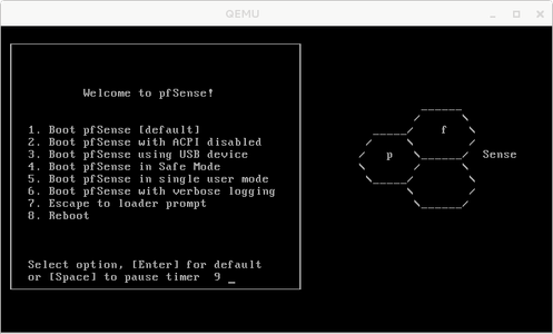

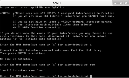

Step 4: First Boot.

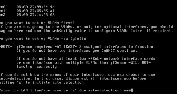

Time to flange everything down and boot the router. You should eventually get a menu. You should be able to boot default. You can ignore setting up vlans for now. That can be done later in the web interface. You will be asked to autodetect the the wan (internet) interface. Then you will want to set up the lan network and be sure to enable dhcp..Once that is done, shutdown and reboot. You are pretty much done.

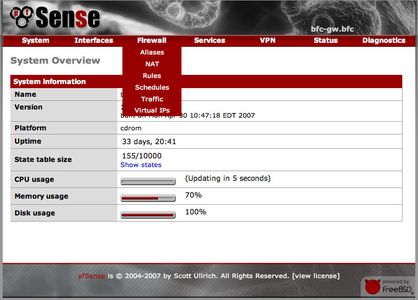

Step 5: The Web Interface.
Once everything is set up for the text environment, you should be able to reach the router via a web interface.
Login: admin
Password: pfsense
From there you can add or change any of the setup. Now you can take your time about replacing your router.
