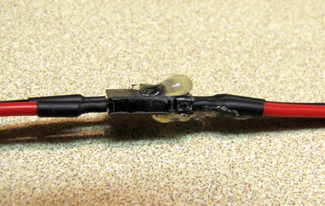

Here is an easy, economical way to make a very small, polarized connector with any number of pins for just pennies. A polarized connector ensures that the plug and socket ends are not joined with reversed electrical connections, which could cause severe damage to some electronics.
Step 1: Reversing Connections Is Physically Impossible
As you can see from the image above, it is physically impossible to mate the polarized connectors.
Step 2: With Polarization, Your Connections Cannot Be Reversed
There is no need for color coding your wiring, but I still recommend it.
You can mate connectors even when lighting conditions are poor and be assured that your connections are correct every time.

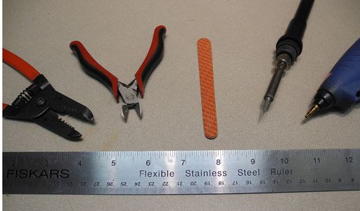

Step 3: Here Are the Tools That You Will Need
Wire stripping/cutting tool
side cutting pliers
Soldering iron (15 to 30 watts with fine point)
Hot glue gun (preferably with a fine nozzle)
Metal rule (or equivalent)
Hot air gun (optional)
Emory board or sandpaper (optional)
Good lighting over your workbench
Step 4: Here Are the Supplies That You Will Need
20 to 26 gage stranded copper wire (color coding is optional)
heat shrink tubing to fit your wire size
fine, rosin core solder
male and female header strips
talcum powder
masking tape

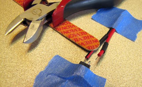

Step 7: Preparation for Soldering
Cut the wires to the length needed. Strip the wire ends back about one eighth inch. Lightly solder (known as tinning) the ends of the wires and the short end of the pins on the headers. Use masking tape to secure the wire and headers while tinning.
Step 8: Soldering the Wires to the Connectors
Cut one quarter inch pieces of heat shrink tubing and before soldering, slide them over the tinned ends of the wires keeping them about half an inch from the ends. Trim the tinned ends to the same length as the short pins on the headers. Tape the headers and wires to your work table and solder the wires to the pins of the headers. You can use the emory board and side cutters for clamping and fine alignment.
Now clean your iron on a wet sponge, melt a very small amount to solder on the tip, and then solder the wires to the header pins. Tug on the wires to make sure you have a good, solid, shiny joint.

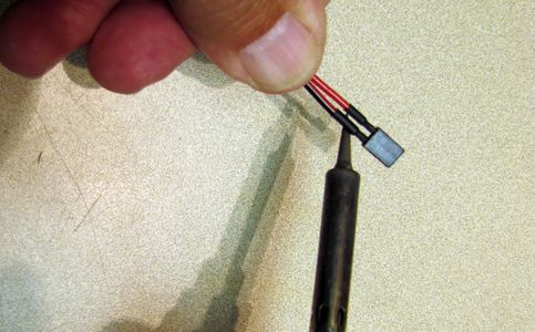

Step 9: Shrinking the Insulation Tubing
After the solder joints have cooled, slide the tubing over the joints so that the solder joints are completely covered. You can use your soldering iron or a hot air gun to shrink the tubing. If you use a soldering iron, gently rub the iron over the tubing and keep the iron moving. DO NOT skip this step.

Step 13: Congratulations!
Your finished polarized, multi-pin connectors should look like this (or even better than this ;-))
