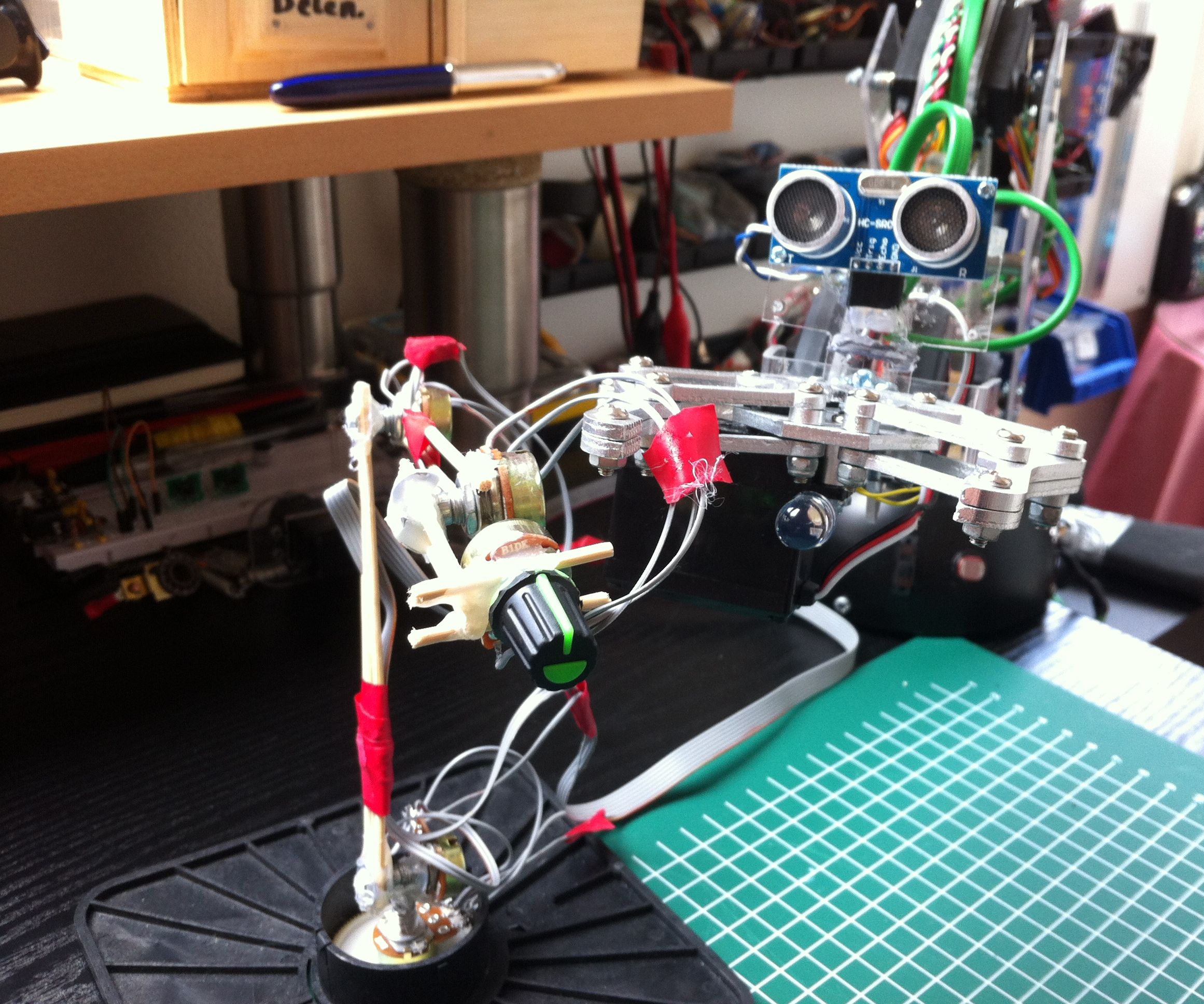

hello everyone,
a while ago i was watching a program about a car factory, and they used robotic arm´s to put the car´s thogetter.
that was the moment were i got the idea of bulduig my one helping hand.
so a time ago i started building on this arm.
and now it is completed.
and i am conna show you how you can build one, or get you some idea´s.
to stared whit i whil sow you were it is build from;
for moving the robotic arm i used 6 servo´s
te body is build from 2mm lexan.
the statif is from a old disco ball (the part were the motor was mounted in)
and i used a distance sensor, and a 10mm led.
the brain is now a arduino, and a power circuit board.
the power it selve come´s from a computer power supply.
in this instructable i whil sow you how to build a robotic arm, and how to use the power supply
i hoop you enjoy it, and if you enjoy please vote for the contest´s
Who doesn't whant a thirt arm on their desk what can help you whit everything you want.
if you ask my it is a real enprovment to your lab.
and it cost less than $100 dollar :)

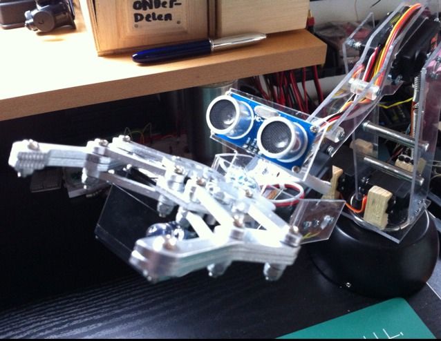

Step 2: Building the Body
You have two rows of lexan to mount the servo's on tose long lexan pieces. And two rows to put the servo's in the rows whit two holes in it. and a U bracked piece on the end. The hand for the arm i jusy bought from the internet. I mounted almost everything whit screws. Becaus when you do somtimg wrong you can change it very eassy
the numbers behind the parts, can you find in the picture.
The lengt if the first part(1) is about 19 cm
And the second part(2) is about 17,5 cm
An the lengt of the front part(3) is 5,5 cm
For the rest it is a bit standaart just look what the besy demencions are for your robot, depents how big or small you want him. for the rest it doesn't realy matter what size you are using.
Now you probely have a idea of building your robitic arm.
The arm needs to rotate 180 degrees total. So we need to ad a servo under the robot. Make a hole in the box and put the servo in there. And screw the arm to the servo. I mount a ring(4) arount the servo so there was no distance between the box and the arm. You can do this if you need it.
To place the distance sensor i used a pice of 2mm lexan and screwed it to the robot hand. I also put a 10 mm led under the hand
You probely need a spring to help to servos for a better movement.
It is hard to explane how to build this, beceaus it is different for everyone. It just depents on the stuff you have/buy. For example if you have bigger servos you need other lexan parts.
And you need to calibrate your robot so it is straight. And whit other parts it is diffrent(so it is not shaking and has a nice movement).
If it is shaking you can ad some weight to the arm. This probely solve the problem
When you build your one body you need to make the servo motor wires longer. Just grap some wire (i used a internet cable whit´s i cut open) and solder 3 pin headers to it. Some heatsinking over it and stick it in the conector. and make a other female connector on the other side. to connect it to the power supply board.

Step 3: Using the Robotic Claw
a servo(can be a futuba s3003 (or another standaard servo) mg995 or mg946 wil work the best))
and you need some screws
so what do you do.
you take a servo bracked and cut it until it fits in the robotic claw.
than you need to use two smal screws to put it in place.
next you take the servo and twist it al the way to the left
now you need to close the claw.
now you are able to put the servo in place with 4 bolds, make sure the servo is al the way twisted to the left
and that the claw is closed when mounting the servo in.
or the claw won't open at all.
now you can plug the servo in to a arduino or a servo tester
if you did it al correct you have now a succes operating robotic claw
make sure that the bolds on the moving parts are not over tightened
or it won't work great.

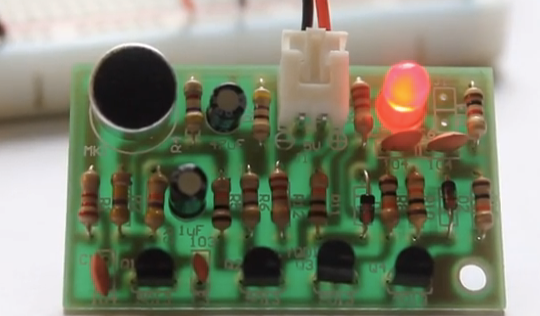

Step 4: Hardware Update
i insert some lights what lights up in the dark.
i used a simple circuit what is really easy to make.
http://www.youtube.com/watch?v=N9z7OQLlhrE
the only thing you need to do, is to find a place to put you led's in.
circuit;
if you prefer you can change the R1 resistor by a 100k ohm potenionmeter.
so it wil light up with more or less light.
and for R2 i used a 118 ohm resistor what works fine wily using 7 led's
if you whant a contra effect you just change R1 with the LDR and it wily light up in the light
and sut's down in the dark.
so the parts;
-R1 100k ohm ressistor
-R2 118ohm ressistor
-bc547 transistor
-LDR
-7 led's 5mm(can be any color)
-on/off switch

the software can do the big thing, you can let him do anything you like
can be realy handy. but it is on you to desside what to do whit it.
i have now everything mounted inside the box, so no lose wire´s anymore.
you can control the arm now by using some potionenmeters or with the disstance sensor
