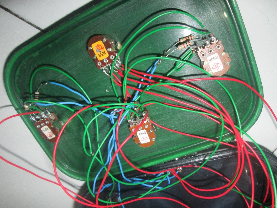

Step 2: Doing
- now print this scheme circuit / you can download it

Step 5: Placing -
IF the paint get dry well , now place the component to the lunchbox
this the component you need to place :
- 4 potentiometer
- 3 , 3.5mm female audiojack
- a RCA female audiojack
- a switch DPDT
Step 6: Time to Work :)
- now get soldering . ( you need to be focus and concent cause the solder is hot :D :D )
- and dont forget to install the male audiojack
