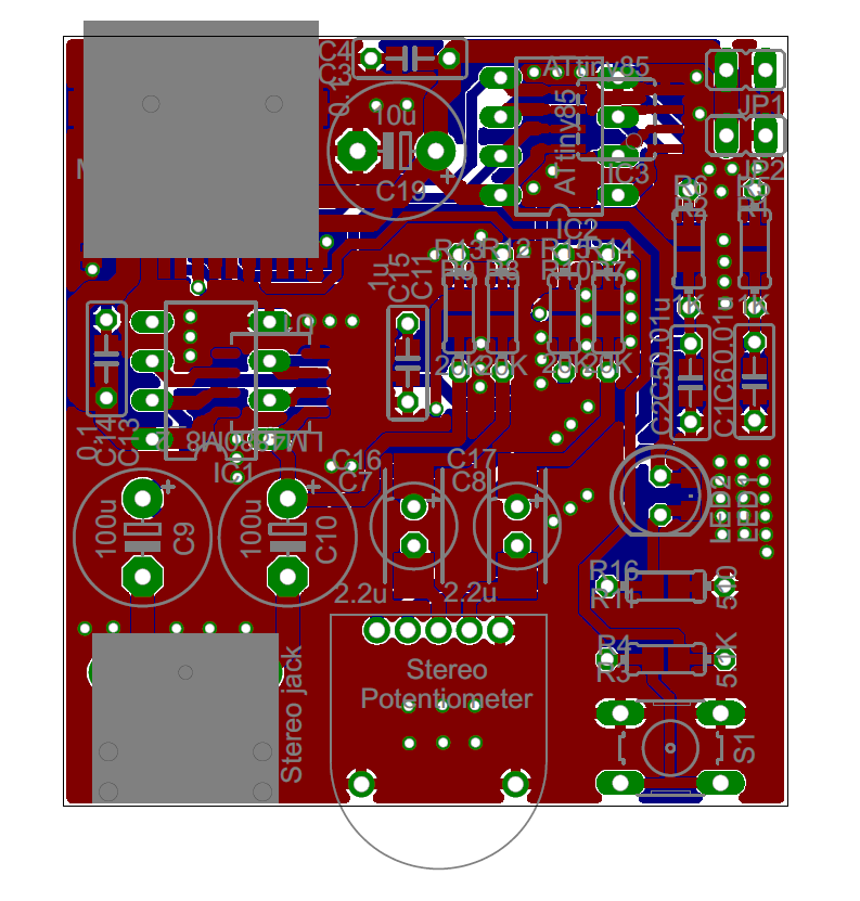

I have added regulated audio headphone amplifier with LP filtering at the output. The music player contains only two chips: Atmel ATtiny85 and Texas Instruments headphone amplifier from the type LM4880, LM4881 or TPA6111A2. It can play RIFF-WAV files with 8-bit resolution and 48KHz sampling rate - not "HI-FI" quality, but in the era of MP3 music, can be accepted :-) . The music files are stored in MicroSD card. They are read by the mcrocontroller and transferred in PWM signal, which after filtering is passed through potentiometer to the inputs of the stereo amplifier. The amplifier can be loaded with standard headphones (16-32 Ohm) or applied to the "LINE" input of power amplifier. The player plays the songs in series - one after one. After reaching the last one, it jumps again to the first. If the knob is pressed during the playing of a song, the player starts the next one from the beginning.
Step 1: The Hardware
The design files in "Eagle" format are attached to the instructable.
As seen in the schematics almost all devices are doubled. This is because the PCB is done in the way, that it can support both through hole and SMD types. Of course only one type device should be soldered.
The BOM (list of used devices) can be extracted from the design data files.

At first I applied audio signal at the top terminal of the potentiometer to check the audio amplifier. It was working. I reprogrammed the microcontroller (twice - 2 additional chips) - the same result. My suspicion was that the problem is either in the card, either in the microSD card socket. I have soldered a SD card directly to the ATtiny pins - Success!!!. After that I have formatted the microSD card in FAT32 mode and put on it only a song. It was working. Adding more songs was also successful.
