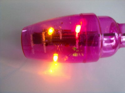

This receiver also has to be fun.So I have put this small chip in a free shaker of pink transparent plastic. Since there are plenty of free pins left, I have added some LED's, which flash a bit when a signal is received. It is important that is seems to be alive...

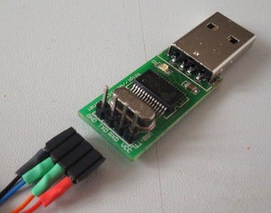

(Why the two kinds of receivers? I bought a cheap UART-USB converter at dealextreme.com, cheap but...only for WINDOWS. So to do the talk from my MACOS side I used the shaker with the jeenode, for which the UART interface has drivers for both XP and MACOS.) For 4dollars you can buy UART-USB converters at dealextreme.com, see later for link, only be careful and check the drivers indicated.)

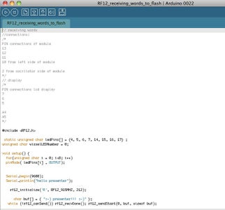

And the last bit of software, the laptop sketch or Flash movie has to work smoothly, "better" than powerpoint! Do some good testing...

one UART USB converter, dealextreme.com:
http://www.dealextreme.com/p/usb-to-uart-5-pin-cp2102-module-serial-converter-81872
(this one has MACOS and Windows drivers)

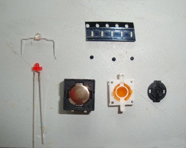

For the rest, some buttons, first I used simple push buttons, but then I found the illuminated orange things at www.sparkfun.com

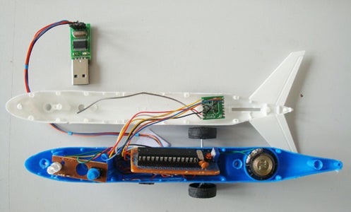

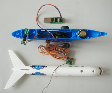

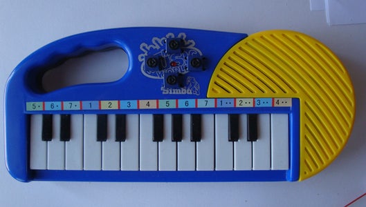

Here are my toy piano, and for XP only the airplane (because of the UART-USB from www.dealextreme.com only had the XP driver) or the pink shaker with a jeenode (for both MACOS and Windows)

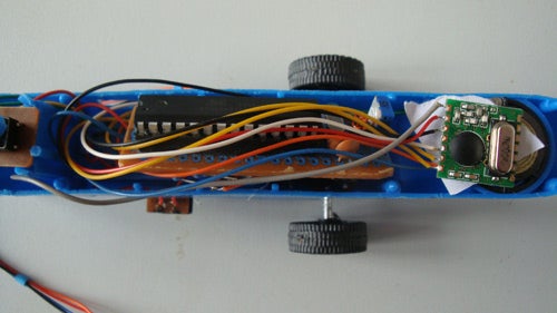

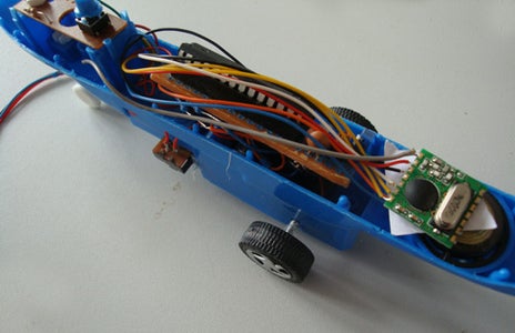

In case of the chip on a PCB, connect the RF12 (or RF12b) like this:
INT0 = arduino PIN2 : on RF12, oscillator side, 2 from top (see picture)
PB3 = arduino PIN 12
PB2 = arduino 10: on RF12 other side 1 from top
PB5 = arduino 13: on RF12 other side, 2 from top
PB3 = arduino 11: on RF12, other side 3 from top
Then on RF12 5 from top, other side, GND
on RF12 6 from top VCC (either 5 V fro RF12, or 3.3 for RF12B )
and the last on the RF12, the antenna a piece of wire around 8 cm, the antenna
The receiving side , my shaker, is the same thing.
The RF12 / Atmega connection. There are free PIN's left, so make something funny!

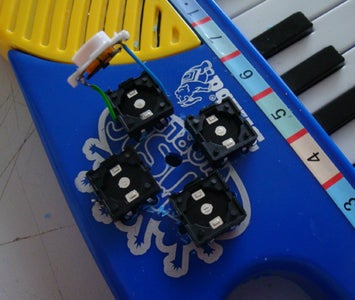

Buttons of the toy piano.
I experimented adding the actions of sending to the piano buttons. But this was not easy (or impossible) the keyboard is driven from the toy piano chip, and the keys do not use a GND voltage, so either the atmega was disturbed, or the sounds were distorted, that is why I decided to add my own buttons.
The pictures show several of my own bare bones setup, and the jeenode. Of course if you have enough space you could use an Arduino too. (in fact for testing before building in, this is advisable!)
RX TX
These are the transfer and the receive PINS. They can be found on the chip and on the converter, Also the jeenode uses these PINS to transfer the data. See picture for connections. Most of the times the RX TX have to be switched between the devices, that is what is for the sender TX is for the receiver RX.

Step 6: The Buttons of the Toy Piano
The keyboard inside the toy piano could not be tinkered with without disturbing the piano sounds. So I added buttons.
First I used boring buttons, then I found buttons with LED's inside at sparkfun.com:
http://www.sparkfun.com/products/10441
(but there was no max voltage indicated...)
You can use four pins of the Atmega for four buttons.
So for programming the toy piano (see next steps for the scripts)
This mending was quite a job, for which I made another instructable:
https://www.instructables.com/id/E7OVAKOGQO5414U/
In the end the worked like this: the LED off - the button is orange, LED on - the button becomes green!
- RF12 code for sending
- basic button script
- four button LED's
- one middle LED
Step 7: The Airplane
The receiver of the messages sent by the witeless toy piano.
WOrking with hardware, always be prepared fro problems. Here the first option was running the Atmega from the toy batteries. These small batteries were fine, but the power dropped quickly. Although the airplane noise was continued the chip didn´t have enough left.
But the UART/USB converter has a VCC pin )and GND of course' so I tapped in with a small resistor to protect the RF12B running at 3.3 V.
Like with LED´s, there is always the different voltage problem to take care of. You would like to run on as little as possible.
Then the last bit was putting it all in the interior of the plane. In the end nothing is visible of the electronics, only the USB wire sticking out!
Step 8: Software 1
There are two layers of software.
The easy thing is: www.jeelabs.com has a fine library for the RF12. This also works with a RF12 in combination with your ATmega328 chip, or Arduino, see pictures. Experiment with the example scripts....
I use a simplified version of this library (included in the xamples). In the arduino script just plain sending (and receiving) the words, "peace", "love", "friend" and "DIY", for four directions.
You have to incorporate the buttons in the sender.
In the receiving end, the receiving gives rise to LED effects (in the shaker), you can program what you like.
A link to the scripts I used:
www.contrechoc.com/blogProjects/scripts_for_presenter.zip
In this zip three folders, one for sending, one for receiving, and an example for how to connect the serial data to a Processing Sketch, see next step.
