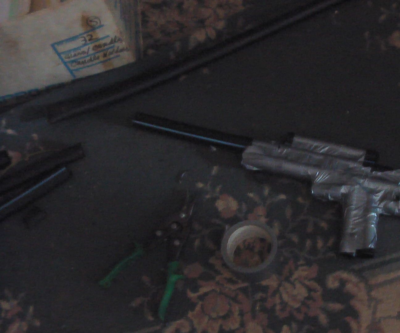

To start, take your PVC pipe and cut two length's as wide as you want your pads, then cut a straight line down the center of the pipes with your Dremel.
Once you have done this you can start heating the pipe with a heat gun(Be careful not to burn it), once it has softened put on your gloves, and pry it apart, then flatten it between the 2x4's. After it has cooled take it out and flatten and round the edges on a belt sander. Then heat it again(not as long this time) then press it over the 2x4 to achieve a slightly rounded shape. you now have your plastic guards
