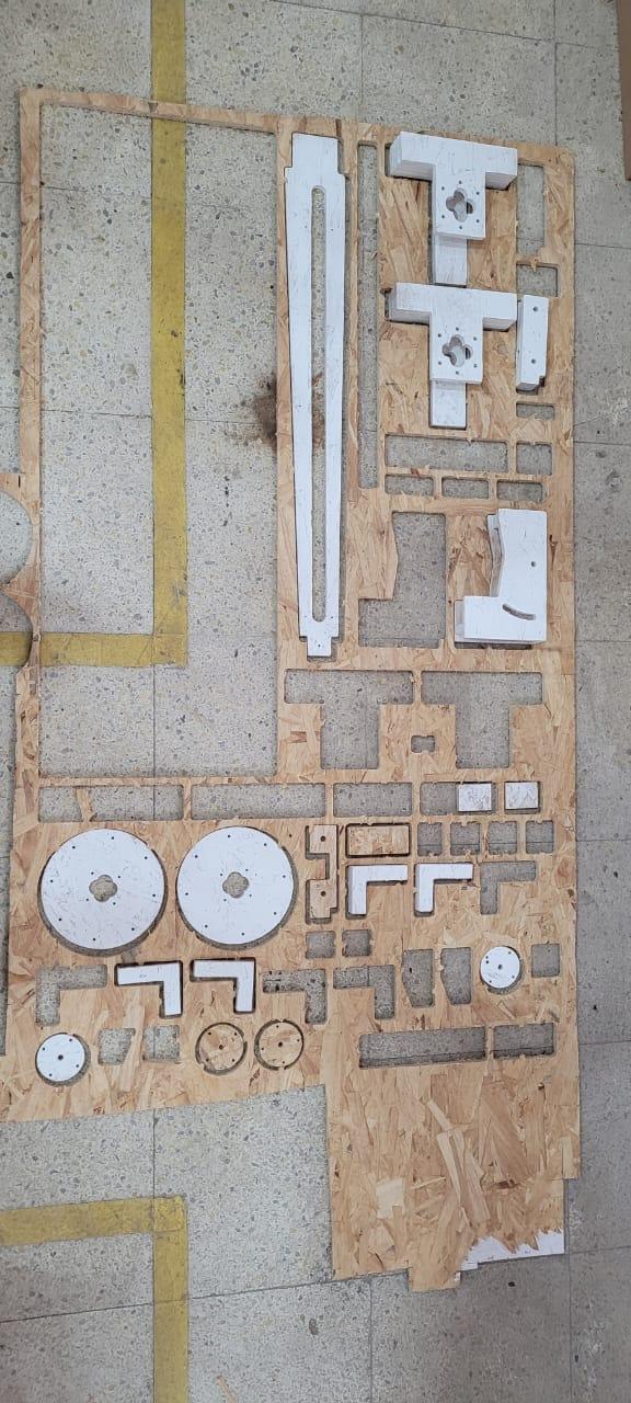

Take a print out of the given PDF in poster mode.Lay it out and stick it on the wooden board. Drill holes at specified points and cut on the given borders(using a jigsaw or a handsaw) to get the basic components of the ventilator body.
Optional: If you have access to a 2D router use the below DXF file to directly get the parts made on a router.

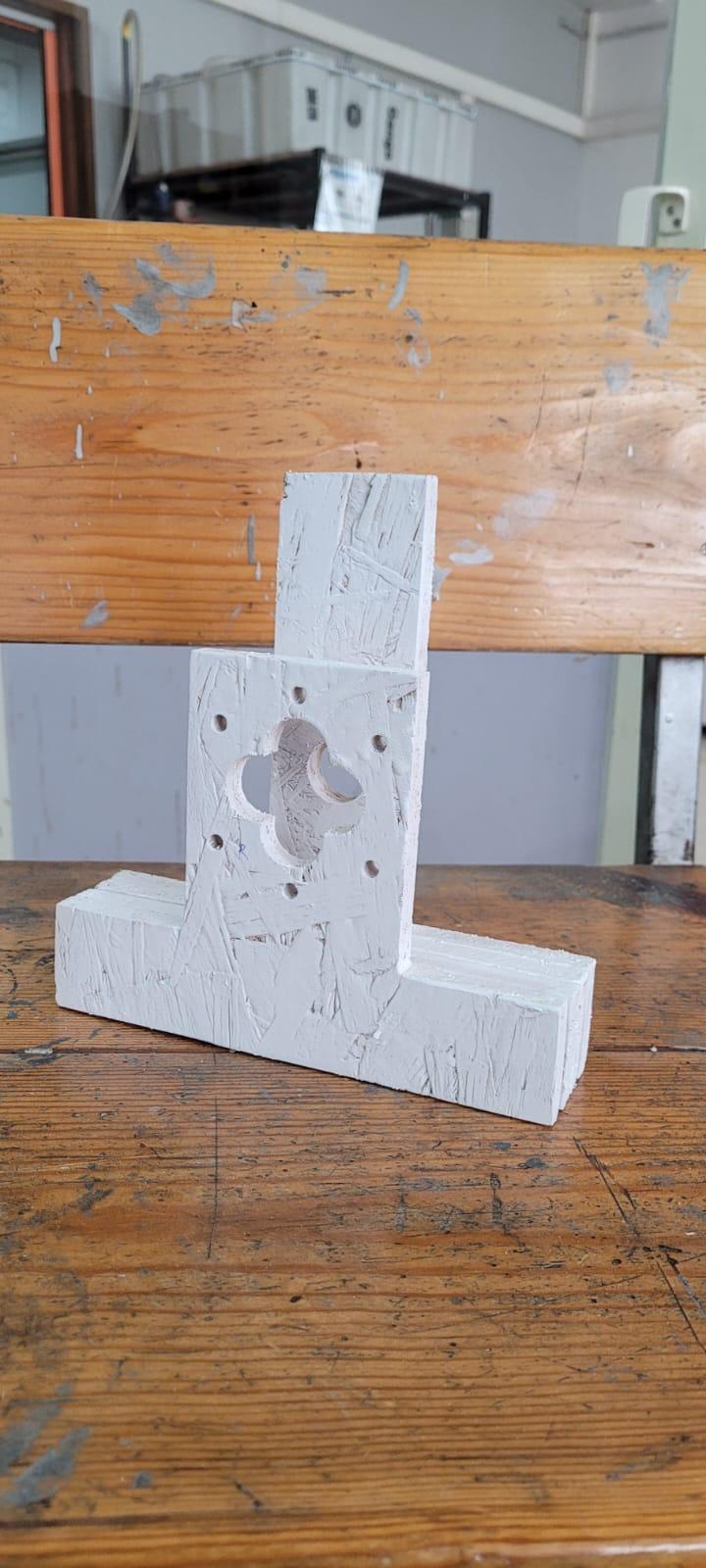

  • Assembling supports (motor side and end cap side):
  1. To make motor side supports, stick the big T and the small T, with 2 spacer blocks in between as shown below. Make 2 of these.

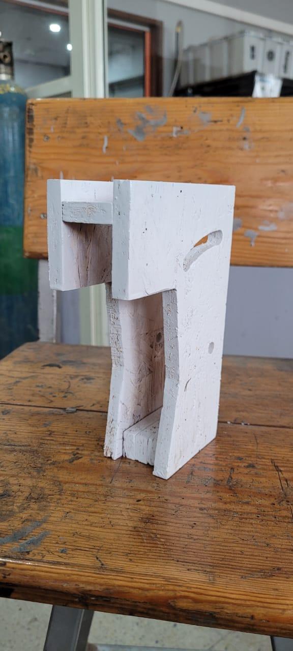

  2. To make the end cap side supports, stick the L shaped parts with 3 spacer blocks in between as shown below.

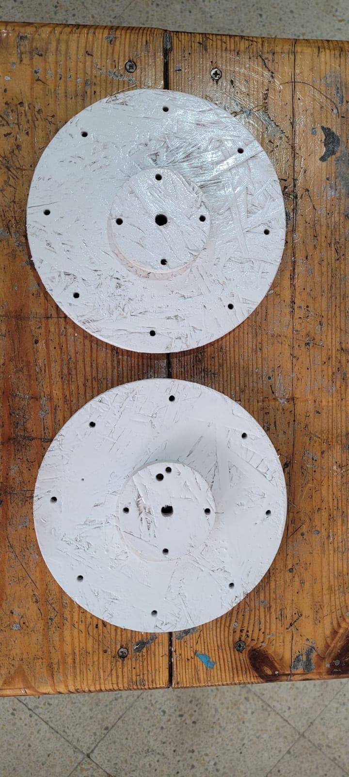

  • Screw the smaller circle part to the bigger part using M4x19 screws.
  1. Screw the smaller circle part to the bigger part using M4x19 screws.
  2. Insert a M8 bolt from the bigger circle side(bolt head on bigger circle side) and lock its position using a washer and nut
  3. Hold the setup straight and firm. Add layers of sawdust and fevikwik over the bolt head to secure its position.
  4. Sand the fevikwik sawdust wall to get a smooth surface .
  5. Make 2 of these parts
  6. Remove the nuts from the other side of the bolt , add spacers and bearing. Position a nut at the tail of the bolt and weld it.( using fevikwik to hold this bolt in position helps too)
  7. Attach these 2 parts , with the smooth surface being in contact with each other.

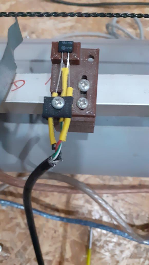

  • Limit switch
  1. Make a bridge from the wood cut pieces as shown in the image.
  2. Attach the photodiodes on top of the bridge and secure it with screws.

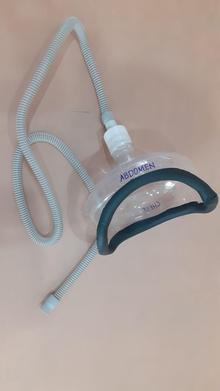

  • Cuirass
  1. Cut the top half portion of a 20 ltr water bottle.(approx 20cm from the top of the bottleneck)
  2. Mark a curve to suit your chest and abdomen around the bottle
  3. Cut it out from the bottle
  4. You can use a hose from the kitchen sink or from a washing machine to connect the cuirass to the ventilator outlet.

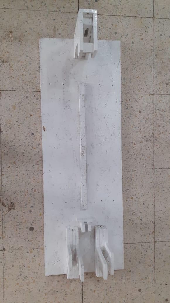

  • Lay flat the base.
  • Screw in and fix the motor supports and the end pipe supports.

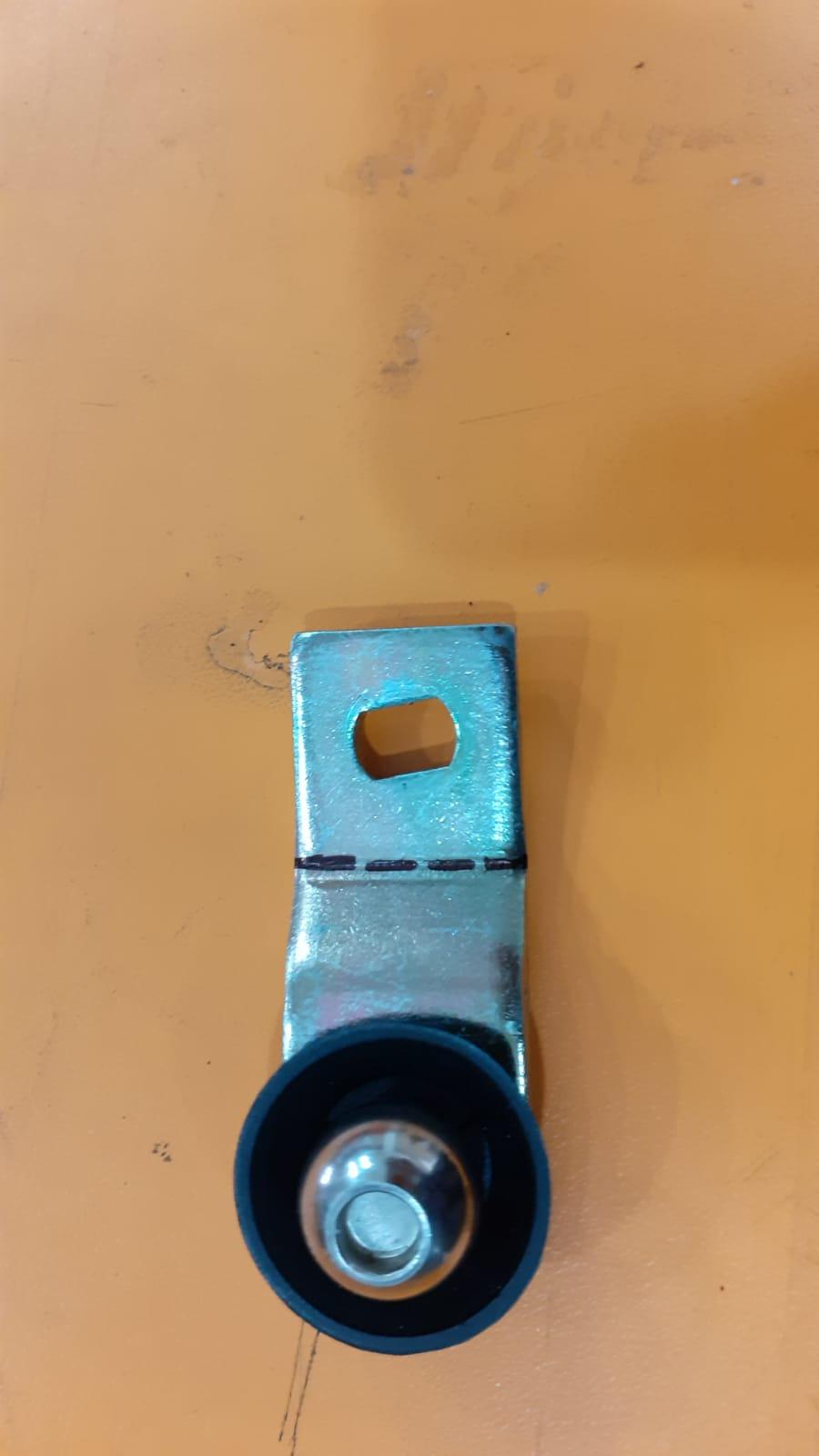

  • Assemble the tension arm
