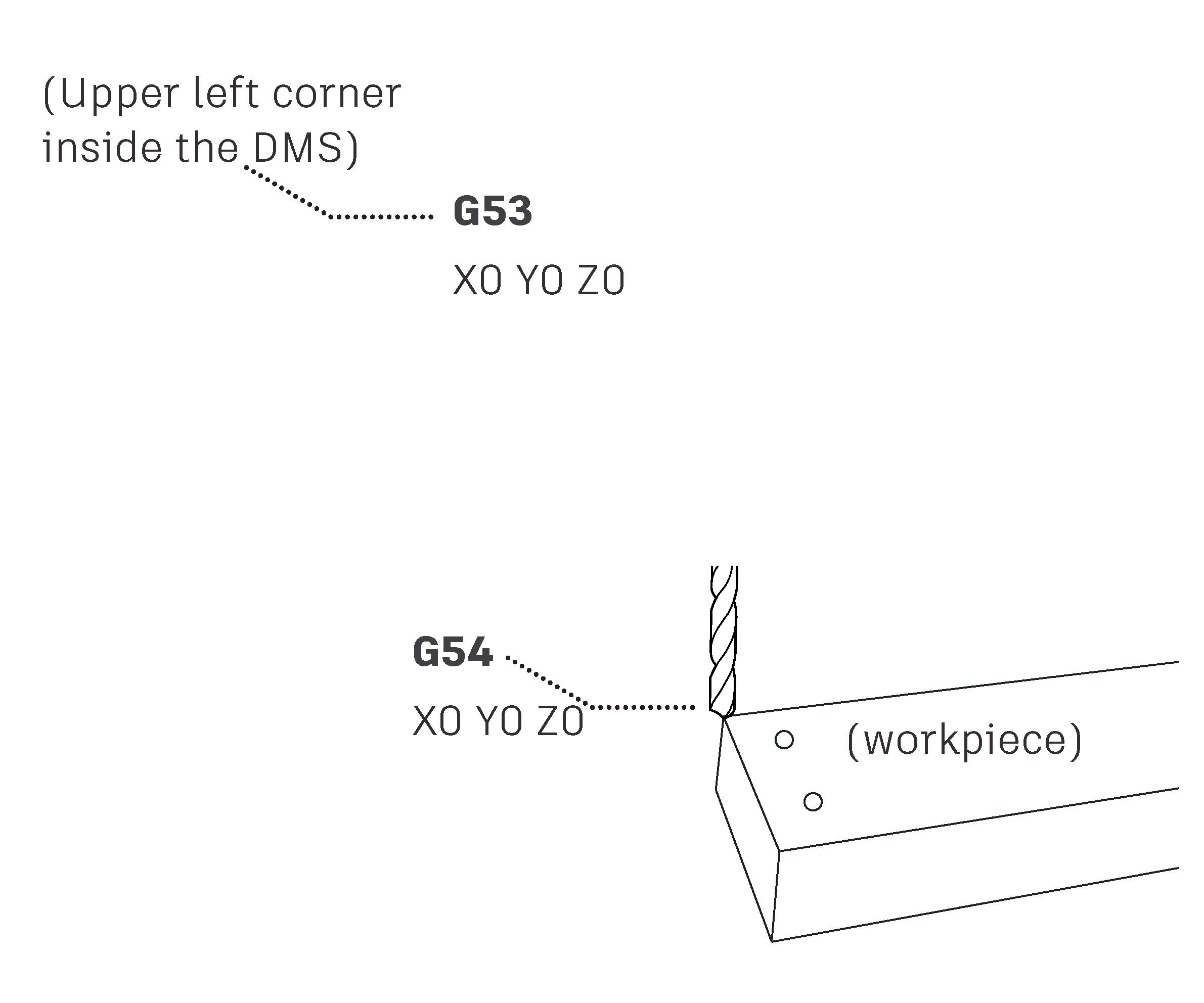

Step 3: G53 and G54
Coordinates are displayed in inches.
G53 is the Machine Coordinate System (Machine Home).
- When the machine is in G53 mode the displayed coordinates are measured from the upper left corner of the machine.
G54 is the Work Coordinate System (Work Home).
- When the machine is in G54 mode the displayed coordinates are measured from the corner of your work (or wherever you set X, Y & Z).
To change modes from the main menu
- Press Jog and MDI to enter MDI mode.
- Type G53 or G54 & press Cycle Start.
