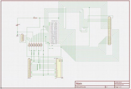

This is the first part of the construction instructions for building a ESP32 Based Home-brew Didactic Computer. I called it the DMSX Home-brew computer as I have developed a MSX like Sprite based BASIC language in order to enable 8th grade students (and higher) to transition easily from Scratch type language to coding, programming some games !
This computer is made on Universal Stripboard so anyone can build it and it's cheap !

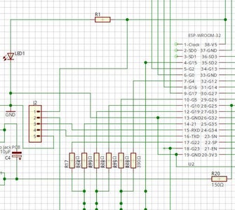

1x ESP32 WROVER-E

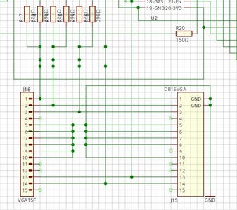

3x 390R resistors
3x 820R resistors
1x DB15 HD Receptacle (VGA female connector)

Step 1: Cut the Stripboard in Half and Add a Male Header
Add a male 90º header starting from left and bottom of the board, line 5 and column 5. Solder it.
Step 2: Cut the Female Headers to Esp32 Size.
Plug the female headers into the ESP32 and cut to size.
Step 3: Solder the Two Female Headers
From left to right, put the bottom header facing the mate header but a line above, starting at the same column.
After soldering the two female headers you can remove the ESP32 and go to the next step
Step 4: Add the 4 Wire Connections
Step 5: Add the 390R and 820R Resistors for the DAC
Step 6: Make the Cuts on the Bottom Side of the Board
Follow the images and the blue line. Count the lines !
Step 7: Connecting the VGA Receptacle
Step 8: Verify for Shorts and Go to the Next Step (the BUS BOARD)
Refit the ESP32, supply it with the 5V from a mobile phone charger, connect the VGA to a monitor and test your board.
