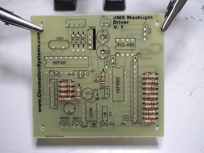

Step 2: Resistors and Sockets
Resistors first.
• R1 is 10k ohm, Brown - Black - Orange - Gold
• R2 is 1k ohm mounted vertically, Brown - Black - Red - Orange
• R7 - R21 Are all 10k ohm 1/4w, Brown - Black - Orange - Gold

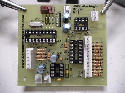

There is a 16 pin, 14 pin and 8 pin socket to place. Align the notch on the socket to the notches on the top-side illustration.
• Carefully align the pins with their holes, check all the pins will go in and press the socket in firmly.

- Find the 20mhz oscillator and solder it into OSC. It has no polarity but Make sure its a good solder joint.

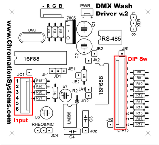

Capacitors Next.The top-side illustration shows their polarity, the black solid stripe is the negative lead.
- Find the two 1uF caps that will be soldered into C1 & C2. They do have polarity, the side with the stripe is the negative lead.
- Place the two 10uF capacitors next. C6 & C7. Again mind the polarity.
- Finally place a 0.1uF disc capacitor in C3 & C4. They have no polarity and can go in either way.
A mistake was made on the part naming and there is no C5.
Step 4: Interconnect Headers
Polarized headers allows wires to be plugged and unplugged from the PCB easily. This project has a lot of switches, potentiometers, mic, that aren't on the board and have wires running to them. The wires are connected to crimps and the crimps are slid into the housings, more details on Step 6
Depending on kit variation some or all of these headers may be included. They are not necessary but make things easier. With out them the wires of the switches ect will need to soldered directly onto the board, making installation harder.
I would recommend to try not to use a header and just solder the wires in directly to the PCB where possible.
There is an illustration of how the headers should be placed on the board. They have a polarized friction lock so a switch or voltage input cannot be plugged in backwards later.
There is a 12-pin, 6-pin, 3-pin, and 3x 2-pin headers to solder.
Press them firmly in, flush with the PCB and start soldering. Careful not to bridge solder joints.
- The 12-pin is for the 10-position DIP switch for DMX Address Selection and Mode Select.
- The 6-pin header is for the Mode Switch and Speed Potentiometer.
- The 3-pin is for XLR hook-ups
- A 2-pin header labled PWR is for voltage input, polarity marked on the PCB
*UPDATE: The polarity markings are reversed on the PCB
- The last two 2-pin headers are for sound input(rheostat and microphone), it is optimal to not install these headers and to wire the rheostat and mic directly PCB.

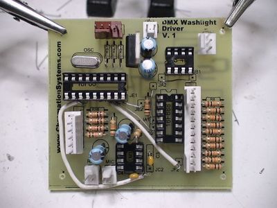

Step 5: Jumpers & 7805 Regulator
Now that almost all the rest of the components are placed, its a good time to do all the jumpers. Which are used instead of dual-layer PCBs.
Use some solid-strand wire and carefully find a route for the jumpers to follow, the path shouldn't ever cross over another jumper wire.
The jumpers are as follows:
JA1 goes to JA2
JB1 goes to JB2
JC1 goes to JC2
continues to JF1&2
*Note: JC4 is a misprint, ignore it.
Final Jumpers: if the output doesn't need the resistors to be used, jump the resistors R3, R4, and R5
Finally Place the 7805 as pictured. Solder it in well.

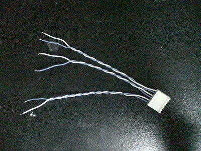

Step 6: Prepare Interconnects
If board interconnects are being not being used skip this step. To continue the rest of the steps some interconnects will need to be wired. Part Pictures and Explaination
To start this step you will need to know how long you will want your wires for the various attachments. All of them are all made pretty much the same so I will only explain how to make the 6-wire interconnect with dual stranded wire. As pictured below.
- Start with 3 equal lengths of dual stranded wire.  Total of 6 wires.
- Strip a 1/8" of insulation off the ends of the strands.
Crimps will have to be attached to one end of the wires.
I have an External Crimp Tutoral Page Covering the Process
Once you have 6 wires with one crimp on each wire. Get a housing that is the right size.
Each crimp should slide into the housing and snap into it. They only fit in one way. Just press them in until they "snap"
The rest of the interconnects, power, mic, sound potetiometer, DIP Switch are all made the same but with a different size housing.

DIP Switch - 9 Positions are used for DMX Address and One is used for Stand-Alone Control. All the positions are pulled-up with the 10k resistors. And are "ON" when connected to GND.
DIP1 on the PCB is Positive and not needed
DIP2 is Ground, one side of the DIP switch will be wired to Ground
DIP3 is Binary 1
DIP4 is Binary 2
DIP5 is Binary 4
DIP6 is Binary 8
DIP7 is Binary 16
DIP8 is Binary 32
DIP9 is Binary 64
DIP10 is Binary 128
DIP11 is Binary 256
DIP12 is for Stand-Alone Mode Selection.
