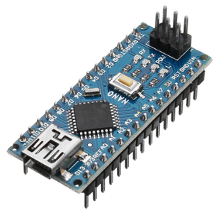

  • Arduino Nano

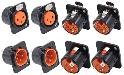

  • DMX connectors (male and female)

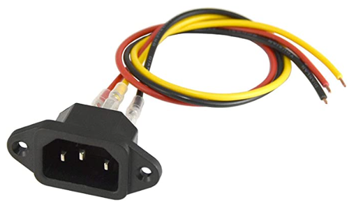

  • AC cord socket

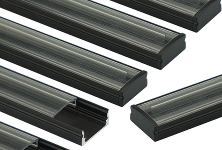

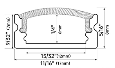

  • Aluminum LED channel (11mm x 7mm x 1m)

The serial DMX signal is now fed into the serial RX1 of the Nano. Using the DMXSerial and FastLED libraries in the code, this signal is decoded and then recoded for use by the WS2812B controllers built into the RGB LEDs.
While one could use a stand-alone ATmega328 microcontroller, it was just easier on the build (and probably cheaper in the end) to use the complete Nano board. Buying a clone of the Nano brings the price down to just under $10, but you may have to re-flash the bootloader. Also, the Nano only has provisions for only one use of the serial port, so you cannot have the RX line already taken by the MAX485 while programming the Nano. I added a single DIP switch to help to switch between programming and normal operation. This single DIP switch disconnects the MAX485 chip from the input RX line of the Nano and allows you to use the serial port for programming. During normal operation, the DIP switch is closed.

Cut a strip of the RGB LED light strip to 57 LEDs. Stick them in the channel with the 57th LED close to the top and working down. This should leave a few inches of the channel without LEDs. This part will be pressed down in the center of the base of the box. Solder three wires on the strip to be fed down the center and soldered to the board.
The PCB goes in first. Then install the two XLR jacks and solder a set of wires to connect loop-through from one XLR to the other and another set of wires to go to the PCB. Both PIN1 of the XLR jacks should be connected and also the "1" of the PCB. The same goes for PIN2 and PIN3. The jacks can be secured with M3-10 screws and nuts. I used tapered head screws and they fit very flush.

Next, install the IEC320 C14 AC socket with three wires connected to the terminals. Again mounting with the same M3-10 screws and nuts. Also mount the single snap-in outlet and connect all the wires. The ground will only go to the outlet. AC Line and Neutral will pass though the snap-in outlet and continue to the PCB to be soldered.

I also snapped on a smoke cover onto the channel and topped it off with a cap that came with the channel. This cleaned it up quite a bit.
