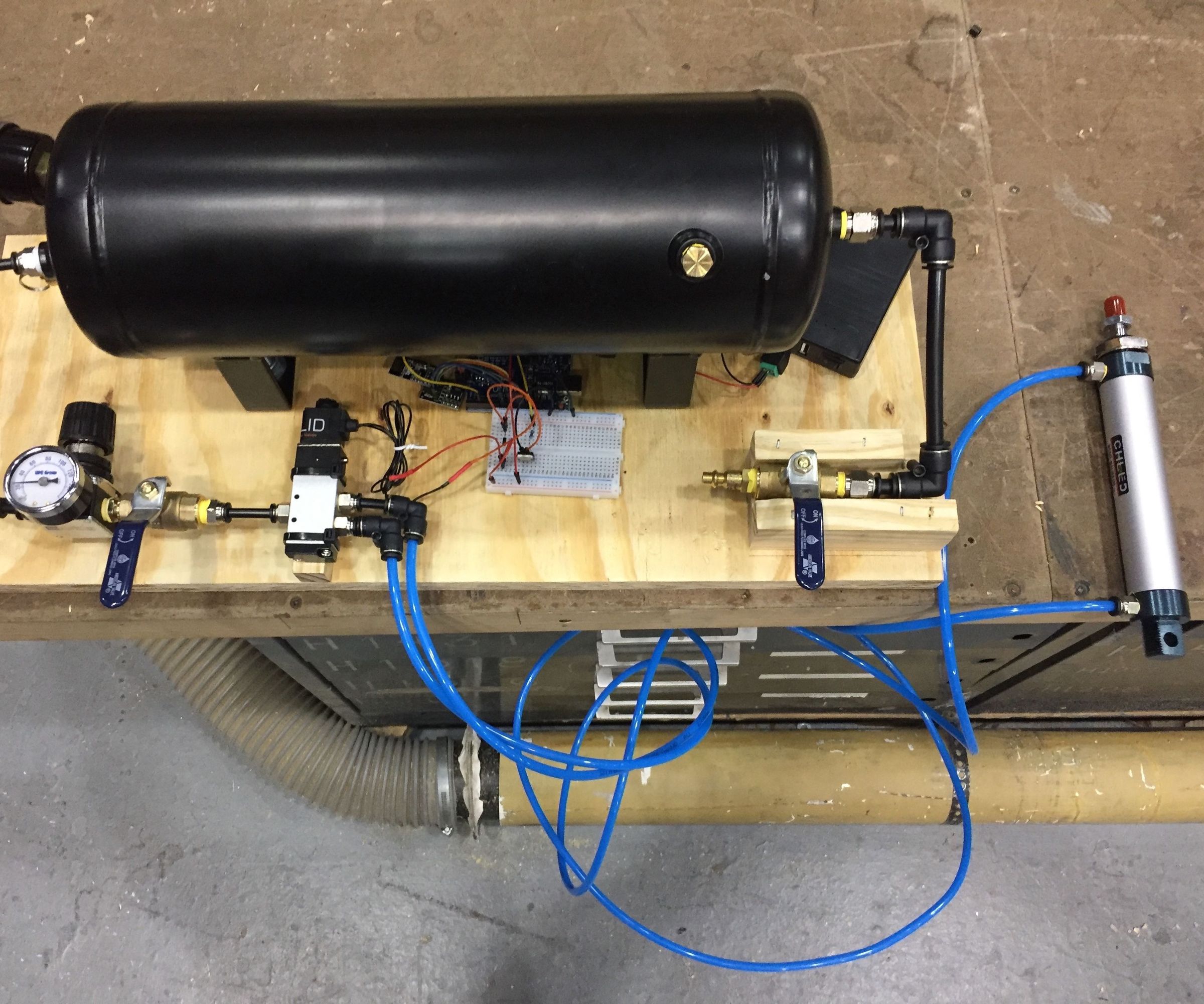

The goal of this project was to make a DMX-Controlled plug box which would allow on-stage effects or devices to be triggered remotely from the lighting console. This could potentially eliminate the need for a separate control system and operator backstage. This controller could be used in a wide variety of applications including:
-Triggering FX (solenoid, motor, other micro-controller, etc.)

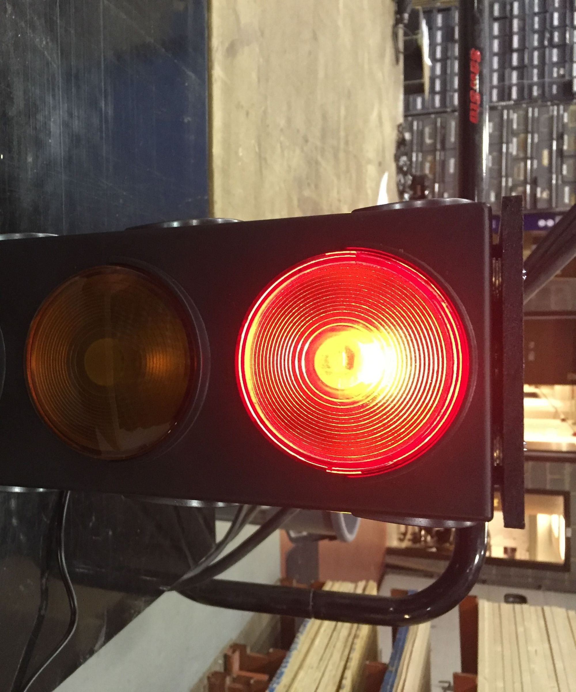

-Triggering practical props (lamps, radios, buzzers, etc.)
-Backstage cue light systems

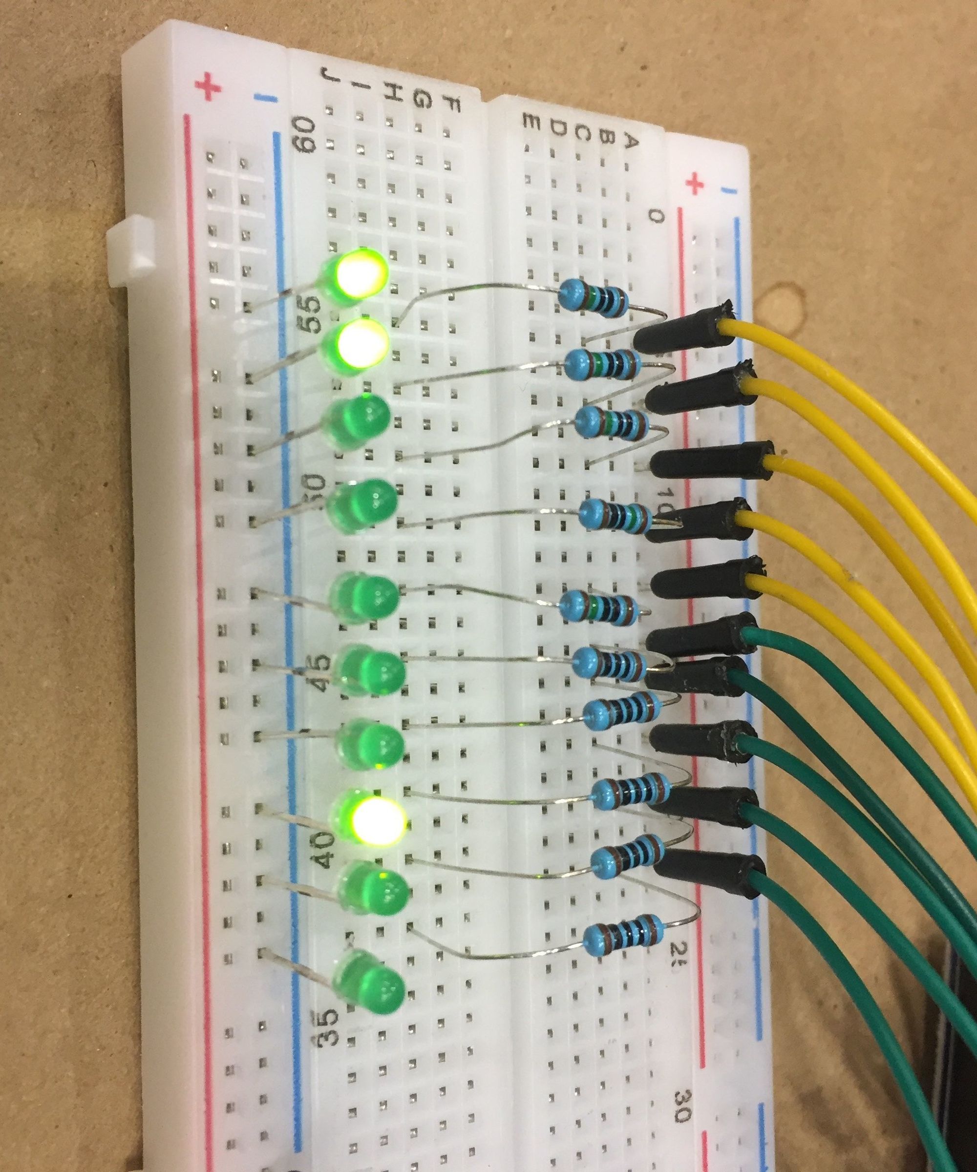

Step 2: Suggestion: Breadboard Prototyping
I would highly recommend breadboarding, assembling all of the electronic components, uploading the sketch, connecting to a DMX controller (like a lighting control console) and testing things out before adding the AC power components and the enclosure. This way, you'll know you're on the right track before you have everything crammed in the box and it becomes nearly impossible to make quick alterations.
