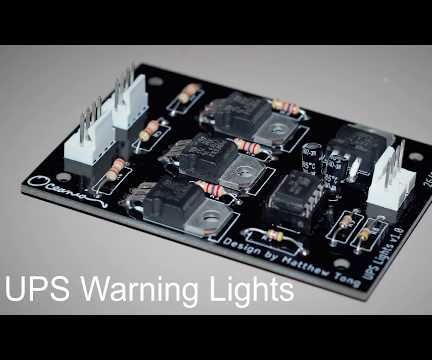

Step 6: PCB Layout
Once again, I will not explain how to use Eagle as there are plenty of brilliant tutorials and videos already available.
This was one of the more difficult steps. Trying to get everything to fit while using the minimum number of vias is a challenge. It took me 4 attempts before I settled on my final design.
For the final design, I started by placing the shift registers as they had the most traces coming off them. Once they were in place with all the outputs along the top of the board, everything else just fell into place.
I kept the dmx circuitry away from the power lines to minimize interference. I don't think it would be an issue but I didn't want to find out.
Note that my design needs to be tweaked to allow the correct plugs to fit. As I found this after the boards were made, I just used normal headers which works fine. It would be better if I had the Molex plugs for power to the board. It will be annoying having to de-solder the power lines if I need to remove the board. I decided these issues are not major enough to warrant getting the boards remade.
I also made a slight mistake in the wiring of the MAX485, hence the wire across it in the photo. As I said earlier.... check everything over and over :) This is fixed in the design files I've uploaded.

Step 8: Soldering
Start with your smallest components and work your way up.
I started with the resistors and caps. Then the crystal and AVR. Then the through-hole components. And finally all the headers. Make sure you place your components in the correct orientation.
Your tweezers will be a massive help here. I also found using helping hands or blue tack helpful to hold the board while you solder.
