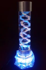

Introduction: DNA Sculpture Desk Lamp: Grown Crystal, EL-Wire, Acrylic, Silicone and Aluminum
This idea initially sprang from a search for crystal based artwork. After poking around a bit, I came to the conclusion that the height of crystal art at the moment can be summed up as "Crystal on Rock", which I found both surprising and unfortunate. Crystals are beautiful and there are so many things that can be done with them. It is my hope that by posting this instructable, it will inspire you to create more interesting and unique crystal based art projects. I also think that 3d printing a sub-structure would be a good idea, but we'll have to try that later.
We'll do this in two parts: the primary art piece and the base. The primary art piece is the interesting bit. Searching for a good base was unproductive, so I built one myself. I'll walk you through some of that process as well.*
*More musings on the reasons behind this decision can be found in the Troubleshooting & Adjustment section at the end of this instructable.
Here is a short video of the end result.

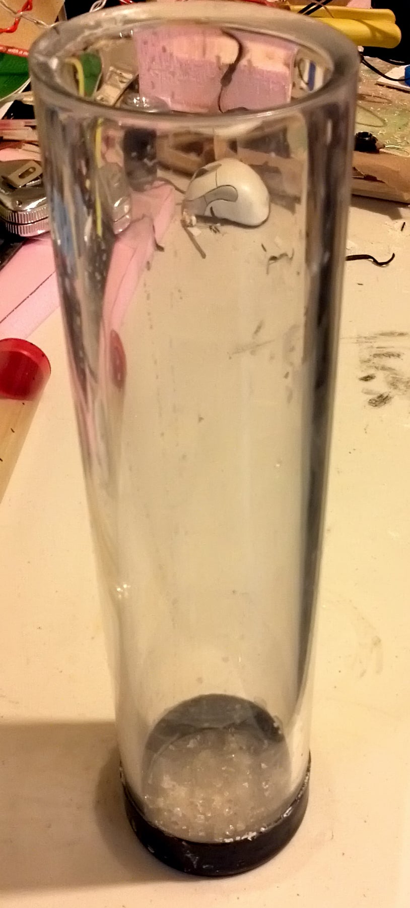

Step 2: Building the Crystal Growing Chamber.
Place the plastic tube cap on one end (the bottom) of one of the sections of Acrylic tubing. Place the assembled tube (open side up) on a flat surface and level if necessary. Cover the opening with something to stop dust and then set it all aside. We'll get back to it a bit later on.

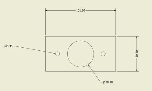

Step 3: Building the Wire Guide.
There are many different methods for coiling wire in the shape that I have. This method was the one that worked best for me and was simplest for me to make out of what I had available.
We will be putting a hole in the center of the bit using the 1.5" (38mm or close) hole saw. A pair of scissors would probably work if you are using cardboard.
First, grab the bit of 2"x4" (50mm x 101mm) plastic/wood/cardboard/whatever. Using a pencil/marker/eyeliner; make a mark in the center of the piece. Precision is not really required; you can eyeball this. Measure ~2" (~50mm) from the mark you made and place a mark. Do this again in the opposite direction. You should now have three marks on the material. The center mark is where the 1.5" (38mm) diameter guide rod will eventually go. The two side marks will be where the wire will be threaded through.
With the 1.5" hole saw bit affixed to your drill; create a hole in the center of the material where you marked. Swap out the hole saw with the drill bit and drill a hole on each of the other marks. Your finished piece should look nothing like this. This was done with the above tools minus the drill.

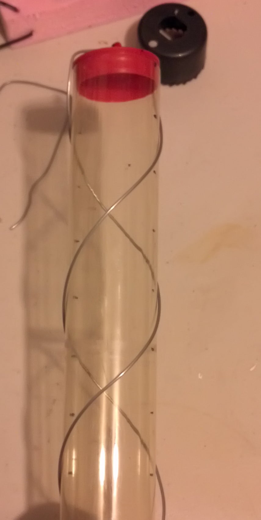

Step 4: Building the Double Helix
Grab the wire group materials. We can start by finding and marking the center of the 42" piece of Ni-Chrome wire. Measure 0.75" (19.05mm) from the center in both directions and make a 90 degree bend. You should have a long U shaped bit of wire. Place this over the top of the guide rod and thread the long bits of wire through the two side holes in the guide. Move the guide to the top of the guide rod near the 90 degree bends you just made.
Place the bent wire over on end of the guide rod and thread it through the wire guide. Move the wire guide to the top of the rod. Start turning the wireguide as you move it down the guide. As you are doing this, check the spacing of your turns to make sure they are relatively even. I think I used one full turn every 2 inches but this is really just a matter of preference. If you decide you would like more or fewer turns, remember to adjust the length of your wire accordingly. To actually calculate the required length, check the Troubleshooting and Adjustment section at the end of this instructable.
After you are happy with the coil you've made, fold the left-over material, if any, 90 degrees. Twist the ends around each other to make a firm support and remove any excess wire. Now you can remove it from the guide and set it down someplace where it won't get smooshed. On to adding the el-wire.* I usually start by placing the terminating end of one of the el-wire strands roughly 1"-2" over the center mark on the ni-chrome wire and secure it with a twist tie or electrical tape. After that bit is done, start wrapping the el-wire around the ni-chrome wire in whatever coil spacing works for you. This part may require a bit of adjustment if you find you end with too much left over. I have found it is best to leave around 3" of el-wire. The primary purpose in doing so is to allow yourself the ability to adjust how it hangs later on in the process.
Repeat that process again for the other strand of el-wire.

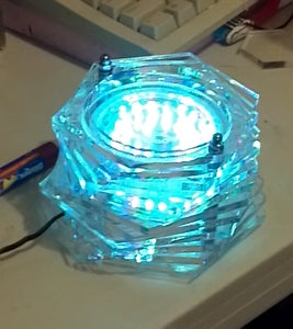

Step 12: The Base
The basic goals of the design are to create an enclosure for the leds, motor, and associated electronics as well as to create a visually appealing base capable of supporting and rotating the art piece.
This can be created a number of different ways and I know very little of electronics. There is every chance that I have done something horrible and improper in all of this. Since there is electricity involved, use caution!

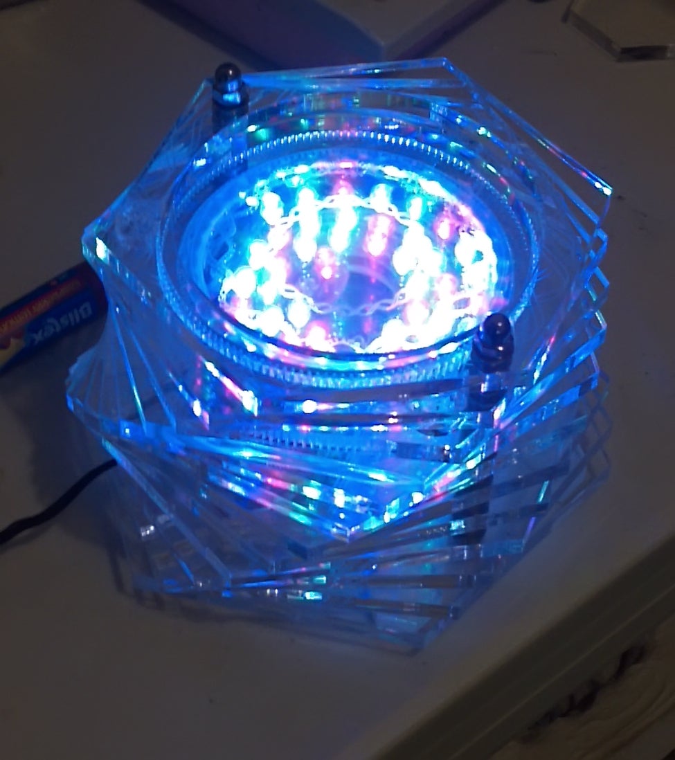

Step 15: Putting It All Together
Sadly, I don't have much in the way of photos from putting the base together and I don't have the parts to build another one at the moment. I will be expanding this section at a later date with photos. But anyway, on with the rest of the info.
After you have all of your parts, including the laser cut base pieces, it is time to assemble it all. **

Remove all but the bottom three layers. Place your color cycling control thingy and the voltage controller in there to make sure it fits properly and to get a good idea of how you want to run your wires.
The electronics
I started by soldering the pin connector that came with the voltage regulator to the voltage regulator. After setting that aside, I stripped the main incoming power wires. I then stripped the wires for the LED controller and connected them to the main power. I branched at that point: with two wires going to the voltage controller and then two out from there to the motor. The ground from the main and the ground for the motor were spliced together.
Before you turn this on; you will want to disconnect the motor and adjust the potentiometer on the voltage regulator to be close to 6V. The specific regulator I used can output up to 7.5V. The motor can probably handle that, but I prefer not to risk it.
Once that is set and measured; you hook up the motor and turn it all on. You should get lights and your motor should spin. If not, check the trouble-shooting section. Woohoo! Almost there.

EL-Wire Problems.
In the process of creating this I have found that EL-Wire can be horribly horribly fragile around the power connection bit. If you find that your EL-Wires are not turning on follow these steps to diagnose and fix the issue.
Test the wires individually. If you are using a Y-splitter and one of your wires goes out, neither will work. Testing them individually will allow you to isolate the problem wire. Once you have narrowed it down to one of the wires (likelihood that both fail is small). The most likely cause of failure is the solder joint on the corona wire. You can try moving the wire a bit and often this will correct the issue. If it fails to do so, follow the instruction on this site to fix it.

Crystal issues
If you find that your crystals are not growing, there is a chance that you have not dissolved enough alum into it. Try reheating the solution and adding additional alum to the mix.
If it has been sitting for four hours and has no visible growth, you may need to add more alum to the solution.
I can't think of any other issues off hand. If you have problems, please post them and I will do my best to answer them.
Calculating wire length for the sculpture.
To calculate the length of wire needed start with the desired height of the sculpture in the tube. In my case I needed roughly 10". So, once you have that figure, you need the desired diameter of the sculpture. In this case it was around 1.5". Now, you need to figure out how many turns you want to have. In my case I had them set at 2" intervals per full turn which gives me 3 turns . Next thing to determine is the number of helical coils you will have, in this case it is only two. So...
Desired Length + (Circumference of guide tube * Number of turns * Number of wires) . => 10" + (4.71 * 3 * 2) = 38.26" I think this may be an incorrect formula....but it does work well enough. *I corrected the original math, still not sure it is correct.
