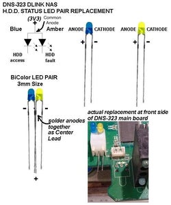

Desolder each of the two T1-3/4 (5mm) size Blue/Amber LED components with three terminal leads each.
Schematic of the replacement context is provided above
The center terminal of each original Bi-LED will be the toughest to clear and desolder. Take your time.
I use a lot of flux and extra 63/37 flux core solder tinning to get the center to 'wiggle' out.
Create a new bi-color LED assembly as shown with two 3mm smaller LED components in the same tri-lead holder. cut one center lead, surface solder the two centers together to form the common anode. The two outer leads are the cathodes (negative). The center terminal is on the 3.3Volt D.C. rail so make sure the soldering of the new common anode is neat and not shorted to the surrounding ground plane. The two cathodes go to the logic circuitry which activates the (two colors of) LEDs on logic LOW.
When you rework a board on the bench, always find the ground return on the UUT target board, and clip it to bench earth (antistatic drain; best practice).
Clip extra bottom side lead lengths of the new LEDs. (1-2mm)
I clean extra flux and residue with IPA 99% or even acetone with wooden swab around the rework PCB area.
I tried to maintain the same orientation and position as the original T1-3/4 LEDs so the new LEDs show up through the front panel 'windows' correctly.

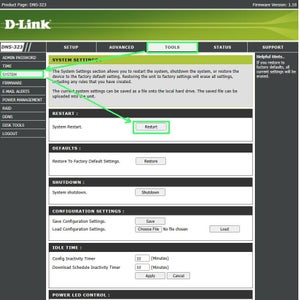

After a brief interval, the DLINK access HTTP page should be available. In CONFIGURATION, check the STATUS pages to see that both drives are OK and visible. Under TOOLS and SYSTEM, hit the RESTART web button and wait for the system to reboot (120seconds or so)
