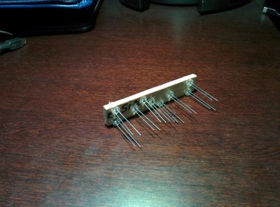

Step 6: LED Lights
I created a light bar with 3 parallel rows from individual LEDs. Each row would contain one orange and two yellow LEDs to simulate a golden glow. Used a 10V DC switching power supply to drive less than 20mA current through each row of 3 LEDs and a 240ohm resistor. This provided high brightness with low power.
