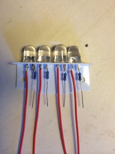

Step 10: Creating the Light Module
I have cut a piece of L plastic and I have made some holes.
I have mounted and soldered White LED ultra bright.
The LEDs are separated so they can be can be switched on and off independently.

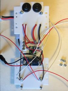

Step 11: Installing ON/OFF Switches and Battery Cable
I have mounted ON/OFF switches which allow to start/stop the robot (left one) and the camera (right one).
I have soldered and fastened the battery cable with a small piece of plastic cut from the original one.
Step 12: Mounting Current Sensor and Step-up
I have soldered the current sensor (to control the amount of current that flows over the sensor) and the step-up to increase the voltage from 7,2V to about 11V (for the camera).
I have also connected the battery cable to the ON/OFF switches and then the power jack for camera.

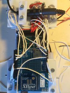

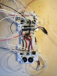

Step 16: Joining All Together
Starting from the lower layer I have joined all layers together with the help of screws and nuts.
I admit: this is the most difficult part! All that wires made me mad! But... I am still here, sane enough! :)
I advise to make small labels and attach them to the wires so you can recognize them when they are on the other layer with no difficulty.
