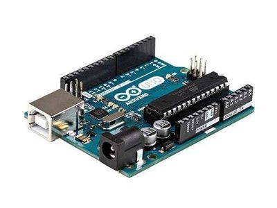

  1. Arduino UNO (or any other Arduino or ESP)

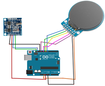

Step 2: The Circuit
  1. Connect GC9A01 Display pin [VCC] to Arduino pin [3.3V]
  2. Connect GC9A01 Display pin [GND] to Arduino pin [GND]
  3. Connect GC9A01 Display pin [SCL] to Arduino pin [13]
  4. Connect GC9A01 Display pin [SDA] to Arduino pin [11]
  5. Connect GC9A01 Display pin [DC] to Arduino pin [9]
  6. Connect GC9A01 Display pin [CS] to Arduino pin [10]
  7. Connect GC9A01 Display pin [RST ] to Arduino pin [8]
  8. Connect Encoder module pin [CLK] to Arduino digital pin [2]
  9. Connect Encoder module pin [DT] to Arduino digital pin [3]
  10. Connect Encoder module pin [+] to Arduino pin [5v]
  11. Connect Encoder module pin [-] to Arduino pin [GND]
  1. Connect RTC DS1307 module pin[VCC] to Arduino pin[5V]
  2. Connect RTC DS1307 module pin[GND] to Arduino pin[GND]
  3. Connect RTC DS1307 module pin[SDA] to Arduino pin[SDA]
  4. Connect RTC DS1307 module pin[SCL] to Arduino pin[SCL]

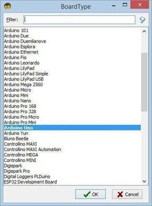

Step 3: Start Visuino, and Select the Arduino UNO Board Type
Start Visuino as shown in the first picture Click on the "Tools" button on the Arduino component (Picture 1) in Visuino When the dialog appears, select "Arduino UNO" as shown on Picture 2

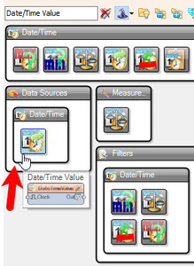

  1. Add "Date/Time Value" component

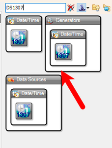

  2. Add "DS1307" component

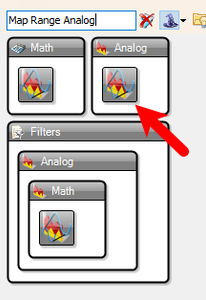

  5. Add 3X "Map Range Analog" component

  1. Select "DateTimeValue1" and in the properties window set under "Value" current time & date
  2. For All Analog Multi Source components in the properties window set "Output Pins" to 5

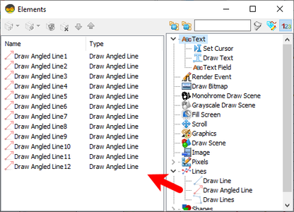

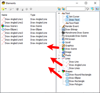

  3. Drag 6X "Draw Angled Line" element to the left side
  4. Drag "Draw Scene" to the left side
  5. Drag "Draw Ellipse" to the left side

  55. Draw Scene1:
  56. In the Elements window, locate the Draw Scene1 element.
  57. In the Properties window, select Elements and click on the 3 dots button.
  58. In the Elements window, add 12X Draw Angled Line elements.
  59. For each Draw Angled Line element, set the properties as follows:

  168. Close the Elements window.
  169. Draw Ellipse1:
  170. In the Elements window, locate the Draw Ellipse1 element.
  171. In the Properties window, configure the following:
  172. Set Width to 20.
  173. Set Height to 19.
  174. Set X to 110.
  175. Set Y to 110.
  176. Set FillColor to aclBlue
  177. Set Color to aclBlue

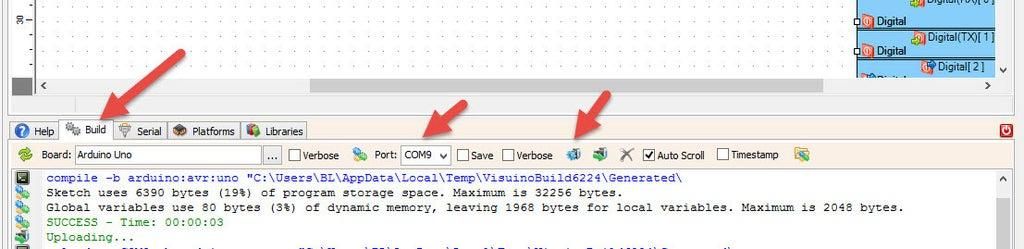

Step 7: Generate, Compile, and Upload the Arduino Code
In Visuino, at the bottom click on the "Build" Tab, make sure the correct port is selected, then click on the "Compile/Build and Upload" button.
