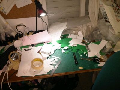

In all the pictures attached I use a green corriboard but obviusly the purpose is to use a black one to block the sun better. But this is what I had so I used it for the design process.

How to make:
Print the outline, stick it to the corriboard and cut according to the black outline. At the grey area don't cut through but just remove the outer layer with some of the inner walls. That's it. fold it and attach to your camera's screen.
