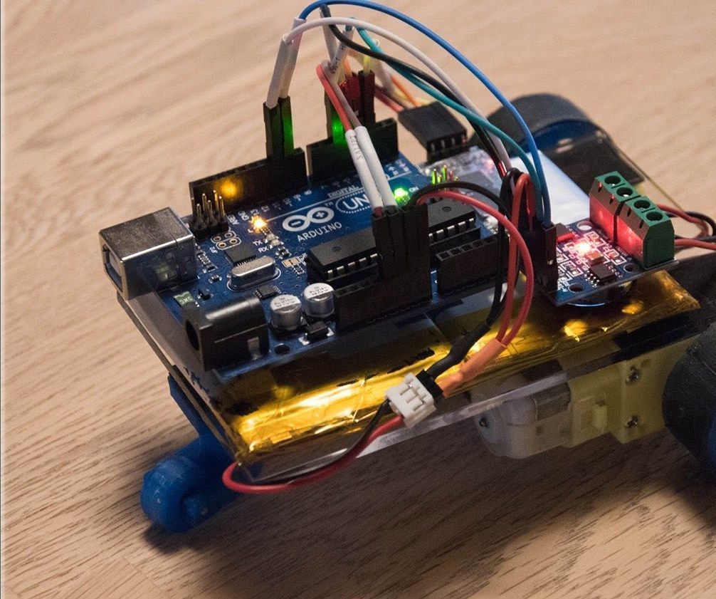

Step 1: Setting Up Your Hardware
SIM 800 GSM Module is interfaced as follows
GSM RX ==> D11 of Arduino
GSM TX ==> D10 of Arduino
GSM GND ==> Arduino GND
GSM Power ==> appropriate ac/dc adaptor, a normal 12v AC/DC adaptor should work with most modules
Relay Module interfacing
Control Of Relay 1 ==> D8 of Arduino
Control Of Relay 2 ==> D9 of Arduino
Relay Board Power ==> appropriate ac/dc adaptor, a normal 12v AC/DC adaptor should work with most modules, there will be power tapping points with the GSM module enabling adapter sharing.
Circuit Diagram for connection is included
