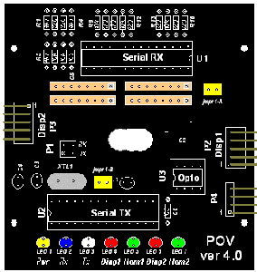

Step 2: Home Made "PCB"
Make the Circuit board
I Use a drawing program thats FREE, called TINY CAD,
made a graphic and printed in colour on laser printer.
Sprayed glue to a fiberglass board, then drilled with a dremel.
Added sockets and parts to my "cheapy" pcb
Made a few types for experimentation..
Wiring is point to point soldering with wirewrap type wire.

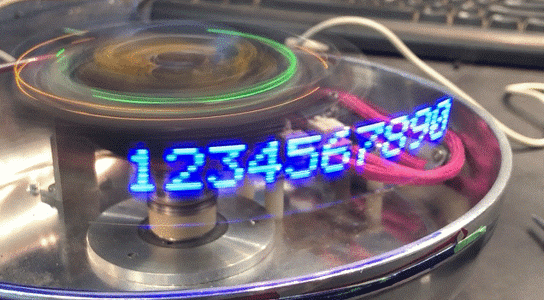

Step 6: Final Look
Finally a few videos of the POV in action
Keep in mind the camera has a SYNC issue, this causes the blank spaces in the video recording, this is not seen with the naked eye
** POV BLUE shows the numbers 1 to 9 on Blue display ( static), via serial
** POV HELLO WORLD shows in Blue "Hello World" as I type from laptop1 serial port to POV unit, listen carefully and you will hear my Speech talker unit say HELLO WORLD, the rear White display is also displaying a 2nd serial mesage from another laptop.
